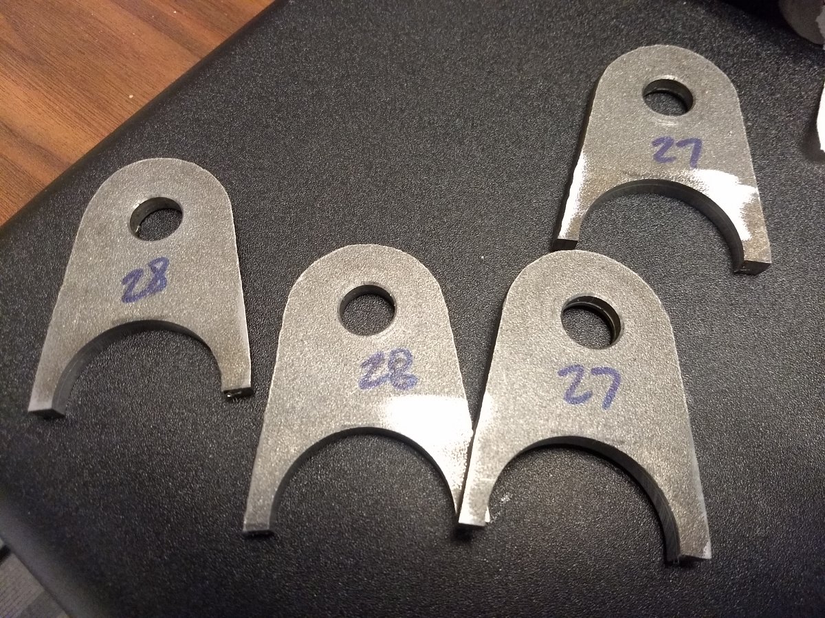

OK, well after the last post, I messed around with things, and I was able to get the height I needed (and a bit more).
Running some geometry numbers, seeing as the car sits pretty low, it was going to be beneficial to raise the front RUCA mount and (re) lower the rear RLCA mount. I previously had the Kenny Brown TracKit axle brackets on the car, and wasn't planning on using them with this new rear suspension. After looking at the suspension geometry, it looks way better to just leave them there.
Once I had that info and was happy with it, I needed to get some tabs to mount the RUCAs to.
I took some generic ones, and modded them to fit.
Then I set about to attach them to the new crossbar.
To make sure everything is lined up, I ran some all-thread through all tabs.
Now that I have these all laid out, I can pull everything apart for clean-up and coating.
