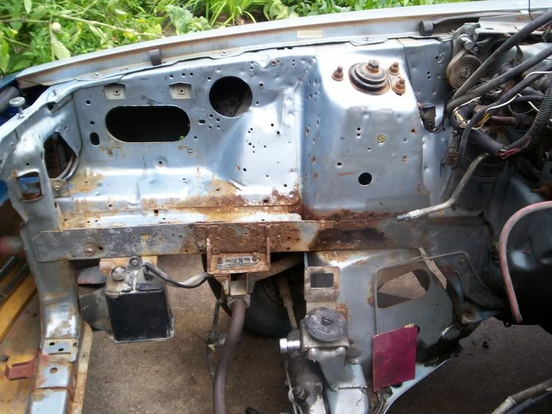

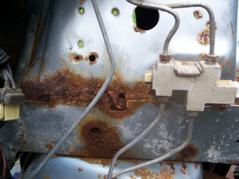

Ok Guys.  I got the motor pulled, and this is what I found.

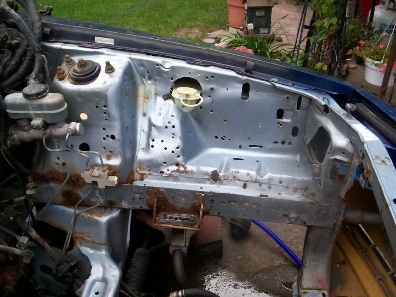

And the outside looking in at the strut tower:
I was kinda thinking about getting some 2"x3" 14ga steel and just replace the whole frame rail.  It doesn't look to hard, but the thing is, I don't have access to a welder.  I might just have to go and get  a cheaper one:evilgrin:
The rear of the car, is fine, just some light surface rust, which I am planning to use Rust Bullet on.
Just want some opinions, and what to do.
I could always just leave it the way it is, and start looking for a rust free donor.

looks fuct to me!

Yup, that's structural. Get in there with a wire wheel and get it all clean so you can see just how bad it is. You could always "clip" the car, but it would be much easier/cheaper to find a rust-free car and go from there.

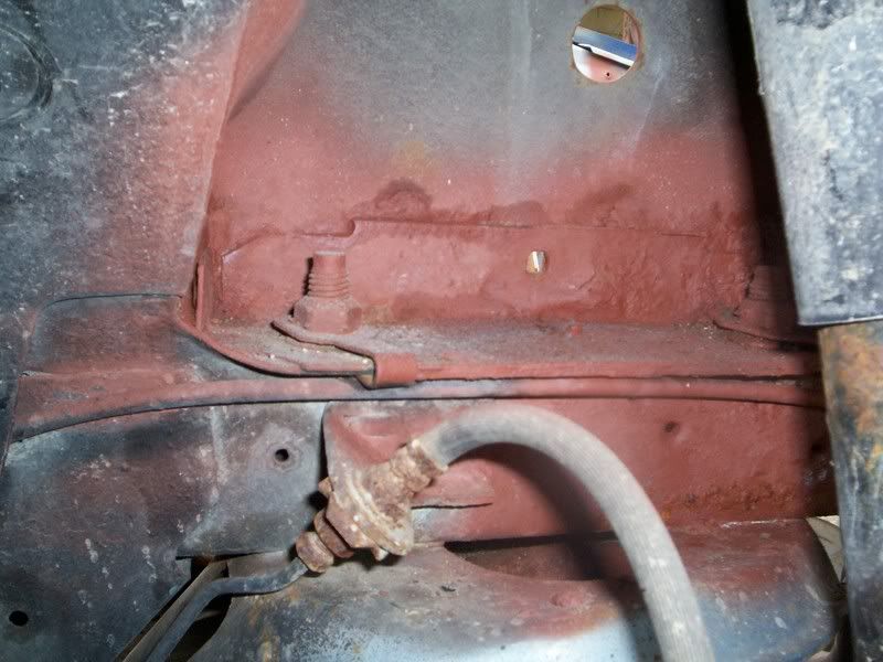

You can fix that no problem. But, yeah, you will need a welder, and some time and patience. I guarantee that inside your frame is alot more rust, more than likely it will all have to be replaced. Here are some pics of mine, it was the same way dude. When I cut open the frame, it was a wall of rust. Pretty bad. Don't be discouraged though, it can be fixed. That rust bullet stuff really sprays on nice too. I used it after I was done fixing my car too. Good luck!
Brian
Work in Progress - DIY Frame Rail Replacement - 56k Hell - Updated 11/15
Here is a finished pic......After I replaced the metal, I sprayed Rust Bullet on the whole front end, then primered, then the painted. Looks pretty good now.

Yea, I took a wire wheel to it, and the places right under the shock towers are gone on the interior of the pass. side, and I've not been able to get the the DS since the brake MC is in the way.  I'm just thinking about getting tubular steel, and just cutting the whole rail out, and replacing it.
How hard is that going to be?
