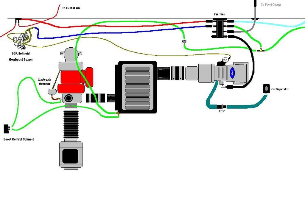

Got any pictures?
88 (turbo) thunderbird has low power
I scored a TC rear just recently by fixing a friends newly purchased TC.  His problems were misrouted vac lines and his lower intercooler line wasn't clamped on right(caused loud hissing).  Fixed both of those problems and the bird flew.  Double check those.  The vacuum line routing can be a bit confusing with a pic.  The tech section at NATO has a crude diagram on how it should look.
