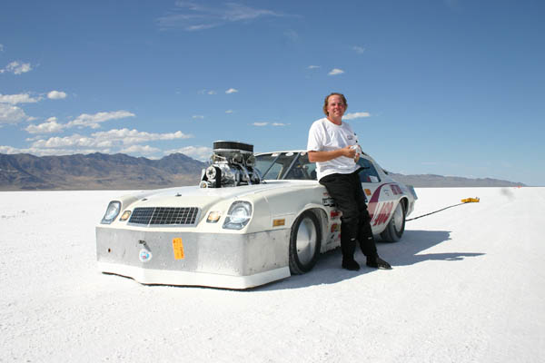

If you have ever read any of the LSR articles in Hot Rod magazine you might have seen this car. It is the one that got me hooked on LSR. I use to crew on this car at Maxton til I decided to back away and re-evaluate life. Losing a close friend sometimes makes you think twcie. Nope that not me in the pic that was this year from Speedweek at Bonneville.
