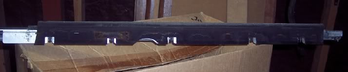

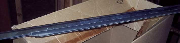

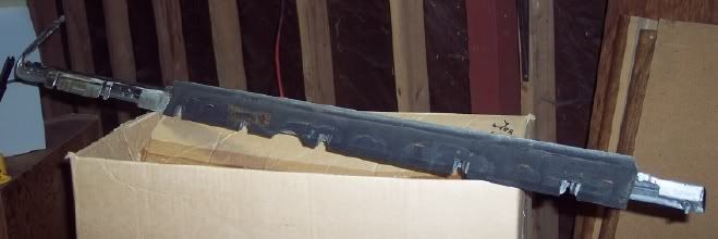

This is a window slider/tensioner... Whats up with the rust? Ill be replacing this. (Dont want scratches on my windows).

Quote from: Romeo2k;169337
Where is that on the door? What part is that mounted on? I think one of mine is rusted.
Speaking of vent windows...
Its attached to the outer dew wiper? assembly.
It's part of the whole lower chrome trim piece of the window.
I'll get you some pics soon, I'm heading out to dinner right now.
**Ok, heres some pics:
Let me know if you need a pic of it on the door or something.
