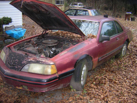

On the day I went to look at Hillbilly Deluxe she had a carbed 351W in her. I can't give you a lot of details as I bought her without motor and tranny. I did manage to snap this pic of it and there was plenty of hood clearance to close the hood.
