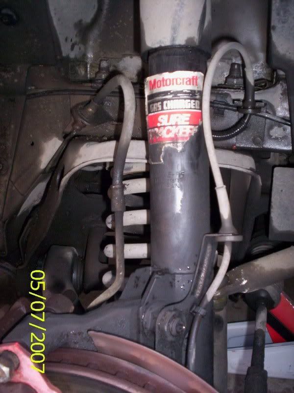

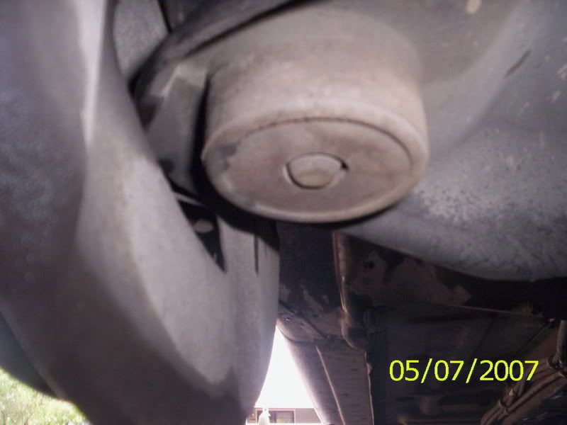

Ok, I have the dreaded RF clunking problem, and as you all know, there are numerous things which could cause this. I took the wheel off today and did a visual inspection, as well as grabbed around and tried to feel for any loose parts. Nothing. I checked the Ball joint by looking at the wear indicator, and it did not appear to be pointing down from the flat surrounding area less than 1mm.
Here are some pictures I took, if anyone sees anything out of the ordinary, let me know. Like I said, all the bushings looked good, and the only thing I can think of is Strut Mount, or possibly the strut, seeing as it appears to be the stock Strut that came with the car.
Bottom of Ball Joint. Indicator does not appear to be sticking out less than 1mm. Appears to be sticking out more. Felt like it.

is the brake caliper tight? simple to over look. just an idea thats what mine was

broken coil spring

Sway bar to chassis mount?

Sway bar,or perhaps the strut bushing up top.Those go bad and there's some clunking going on.What is all that wet stuff?Leaky brakes?

Broken spring on the LCA on the bottom?

Took the pics after pressure washing all the dirt that had accumulated in there over the years. Two people mentioned broken coil spring...how can I check that?

should be able to visually look at the bottom see if it looks sheared off
RF Clunk/Photo Inspection
usually the spring will look good until you remove it then it will be in two peices, as it brakes in the rubber on the bottom

Quote from: cougarman;145616
Exactly.  It's not the sort of thing you can peek around with a flashlight and see.
You might be able to get a prybar in to move it around and see?
I didn't know for sure mine was broke till I got it apart.
I had a slight clunking noise (and an annoying squeaking sound) coming from the driver's side front. Spring was broken. Swapped on new springs, the clunking sound has apparently gone away but the squeaking is annoying as ever...I have a hunch it's the strut or strut mount.
