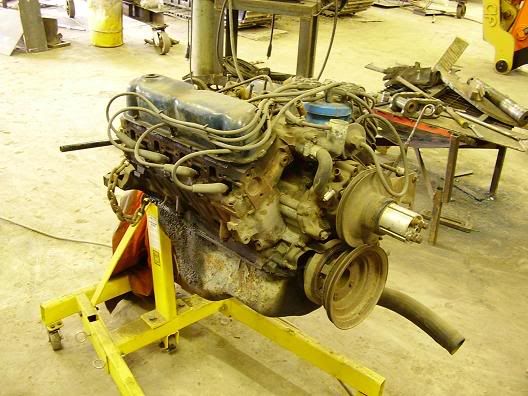

I got this 351W for $100 and some random change I had in my pocket, 45,000 original kilometers.
Of course it was attached to this
I sold the wheels/tires, doors all around, seats, and some interior pieces  so the 351 cost me about $-350 in the end :D Now I just need something to put it in, hmmm
