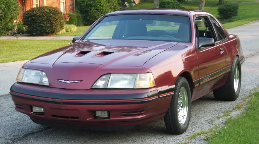

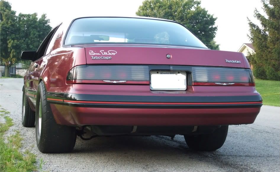

As for the rear, I have gotten 325-50-15's in the stock fender well with a rolled lip.
Quad shocks removed.
Wheels:
15 x 10 with 6.5 backspacing.
tires 325-50-15 BFG drag radials.
Stock width T-Bird axles.

Quote from: 83-88T-Bird Guy;427758
Wheels:
Nice looking TC there!
