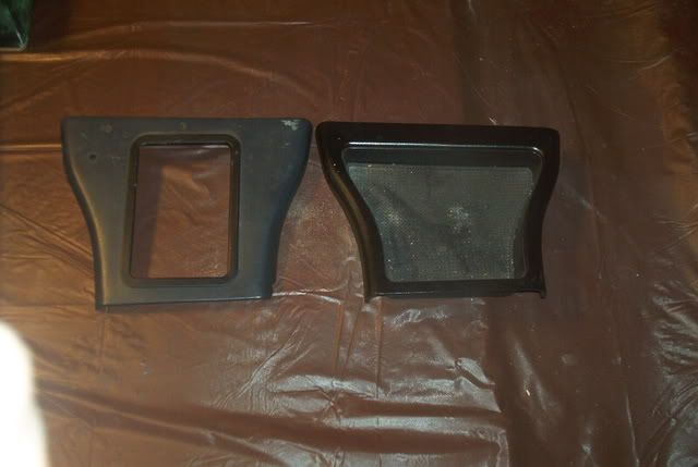

Is this what you are fixing? (on the left)
Dave, I hope you don't mind me using your pic.

Quote from: daminc;211612
I used trim paint on the blacker one,but that doesn't put the design back in.I sanded the whole console,and painted it.The results were good ,but I could of did better.

Quote from: kitzdnm;211615
It did come out pretty good though
Restoring the ripple texture
I have sanded + painted things before and it looks better, but in my opinion its not the same.  That is the piece on the left on the previous page but the sloped piece with the ash-tray and switch mounting holes  would also need the same treatment.
