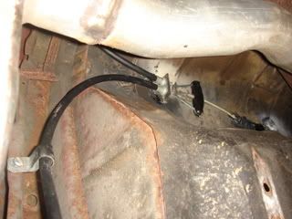

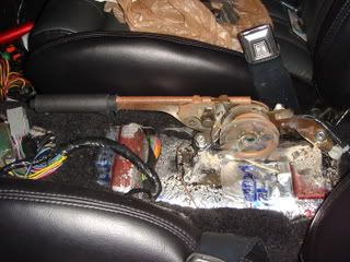

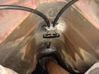

Just finished up.  I know there are probably quite a few flaws in my design, but I'm new to any type of fabrication/welding and I had to have my parking brake working by the end of the weekend.  So here's what I ended up with  :D  Oh, and there was very little room between the floor and driveshaft to work with (about 1.75" or less).  Hope it's works out with suspension travel!!

Booksix-I have a Mustang (1994) lowered 1 1/2" and  a big problem with these cars when lowered is the drive shaft rubbing the brake cable bracket when you hit a big bump. I had to use washers on my pinion snubber to limit my suspension travel. Hopefully you won't have this problem with your bird.

Wow, that's crazy!  I never heard of that issue.  When I realized I had so little room my first thought was "Ford must have made the hump higher in the mustangs to allow room for the cables."  I guess we'll see, but thanks for the heads up!
And now I should probably double check the diameter of that aluminum DS I just scored from the JY.  If it's larger than my stock one I don't think I'll be having is cut down.
