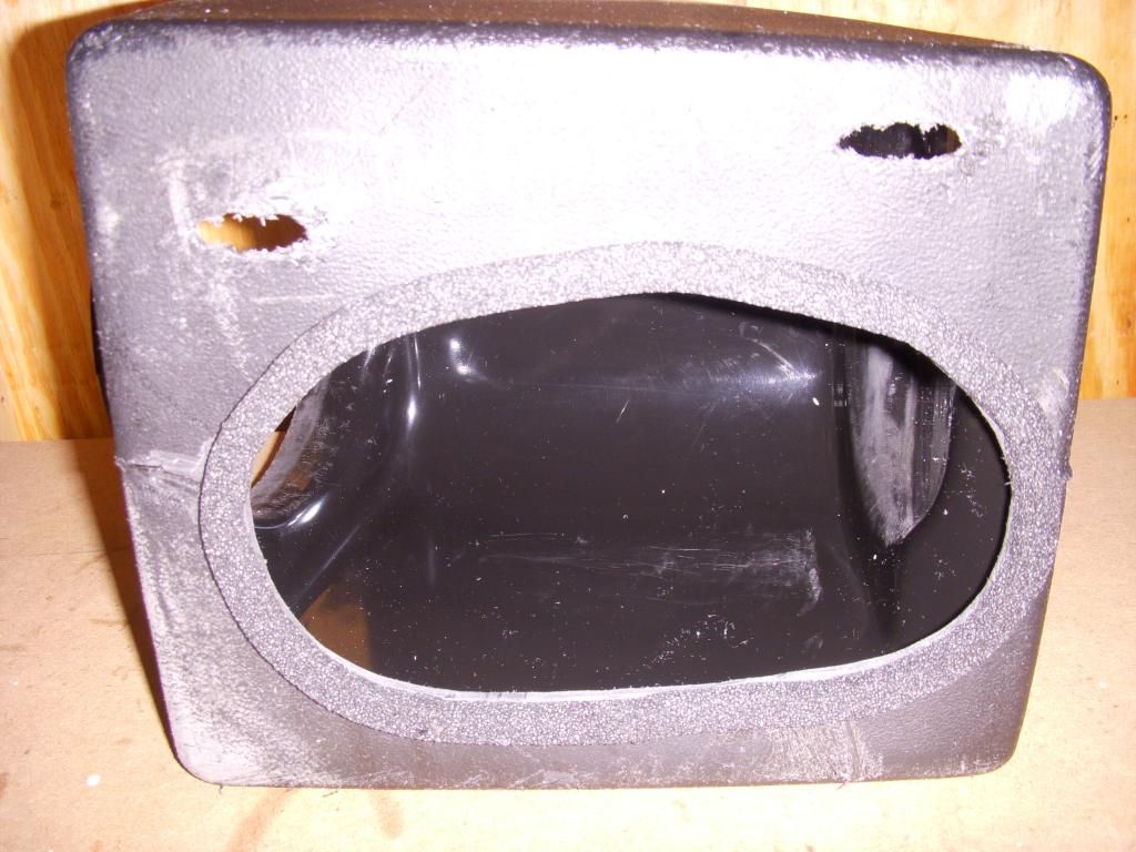

Well I finished modifying the March ram air box. I removed the snorkel, enlarged the hole for air intake to match the fender, slotted the mounting holes so I could line the box up with the fender hole, and put some weather strip around the opening so air can only be pulled from the fender well. The box as molded sat further back in with the original holes and didn't fully cover the fender opening. This was done so the snorkel would clear the fender opening with the hose attached. My Dremel got a workout.
Now I just need the correct sample tube and the K&N filter to show up and I'll swap this on. I think it should pull in a decent amount of air ;).

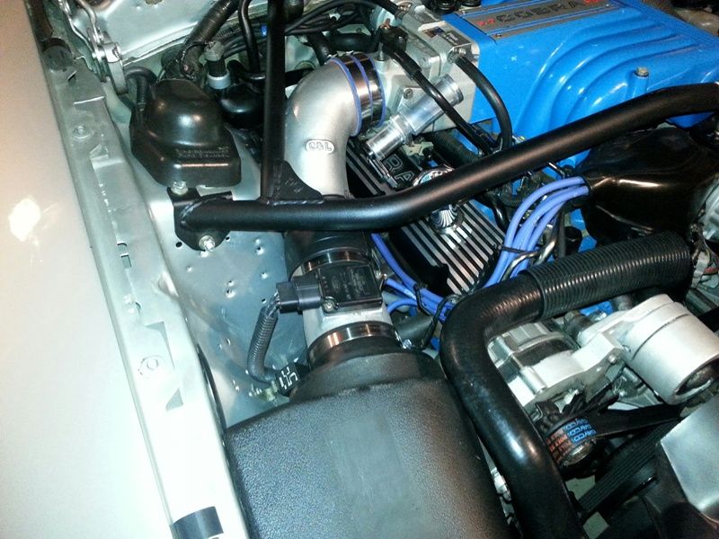

I got the K&N Conical filter and the correct MAf calibration installed yesterday. I didn't take it to the track (hopefully in the next few weeks) so I just drove the car around on the street. I don't know if it added any power however it takes noticeably less throttle application for the same amount of acceleration. The engine seems to rev quicker than it did with the stock airbox and K&N panel filter. Passing power on the highway has been improved as the car responds faster. It should be noted that all of this is courtesy of my calibrated butt dyno ;). I will get track results and post them. I took some pictures of the setup (sorry cell phone pictures at night). March Ram Air box with snorkel removed and the hole in the box enlarged to the fender opening, K&N RE-0920 conical filter, 76mm C&L MAF, 4"long by 3.5" ID rubber coupler, C&L true flow pipe (76mm ID).

Pretty much what I did to my box.  I'm waiting to install.  Been looking for some type of extension for the front end.  of the MAF to make my filter come forward approximately another 3/4".  I want my MAF mounted on the shock tower just like it is right now.  I may end up just buying a small piece of 3.5" I.D steel tubing then cutting it to the length I need and cleaning it up.  The temps dropped here already.  Been in the mid 50's at night so heat soak has really been non-existent at this point between that and the new rad.  Add to this how busy I was at work in early August (10 days in a row stuck late......FUN) and I just didn't have time.  Oh yeah, I'm back on steady midnights now too (FINALLY!!!).  So I'll have some free time to mess with it next week.  This week I'm closing my pool.
