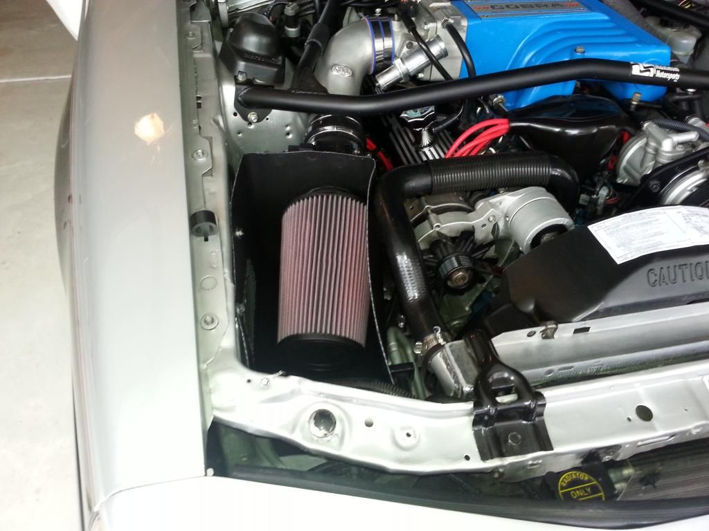

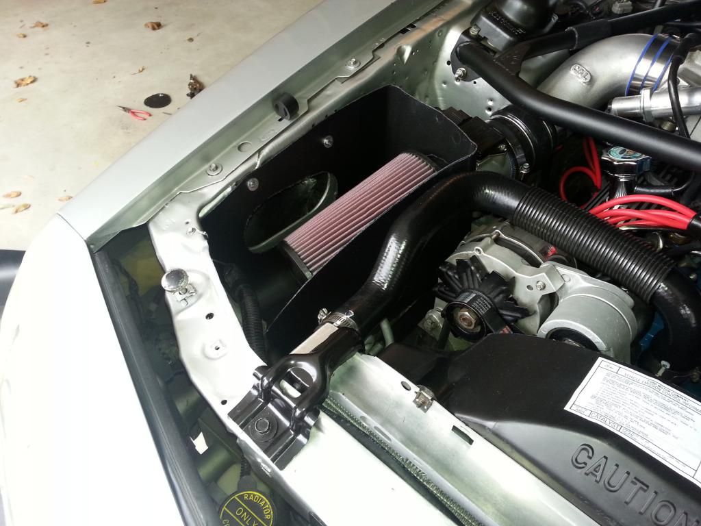

Also as far as filter shields go this may be another option besides the March Ram Air box:
It's a heat shield from JLT cold air for 99-04 Mustang GTs. It's only $39, which is cheaper than buying a new March Ram Air box: http://jlttruecoldair.com/ZenCart/index.php?main_page=product_info&cPath=132_137&products_id=383
This is how it looks mounted in a 99-04 Mustang GT.
It looks like it might be an option, depending on the angle of the piping used back to the throttle body.

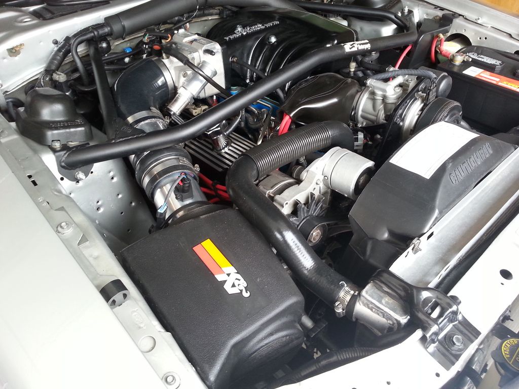

Well I changed some more stuff for fun. This is what happens when you sell some old parts and work some OT :hick:. I have been running a 76mm C&L MAF with their 76mm intake tube. The car ran great with no issues.
Because hot rod I couldn't leave well enough alone. I have been interested in a slightly larger MAF that I could tune later one, i.e. one that had a better, actually usable transfer function unlike the C&L unit. So I purchased a 80mm PMAS slot MAF calibrated for 30lb injectors. It comes with a 30 point transfer function and has the benefit of being a new, 2005 and up, style slot MAF. I also replaced the piping between the back of the MAF and the throttle body with 3.5" diameter tubing because a bigger MAF means more airflow ;). I swapped this stuff on today. The car runs great without any issues. Upper RPM throttle response feels slightly better as well.
Cold air intakes
Reply #134
Where'd you get the black tubing goi g to the throttle body?
