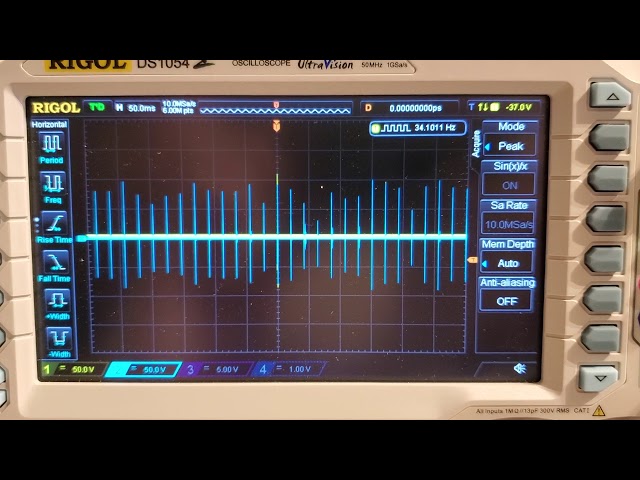

With the stock ECU/tune, 19lb injectors, and stock MAF. We did some tests and eventually got to revving the engine. Above 4-4.5k, getting some heavy popping out the exhaust after a few seconds, and tach dropping down. Happens with both SPOUT in and out, but seems to be more drastic with the computer advancing the timing (occasional 1k rpm drops instead of 300-400rpm).
Purchased 2 timing lights and chopped them up to test coil wire and individual spark wires. Not seeing missing spark, but the inductive signal being read by the oscope shows some signals being picked up almost half the strength of others, out of the coil itself. Difficult to properly test this though, with the inductive readings. A recording showing some of the signals (ch1 coil, ch2 wire):
At 0:26, it shows the signal zoomed in. 50μs scale has some common 25μs discrepancies, but I have no idea what's normal.
https://www.youtube.com/watch?v=7AjDoco1fQc

Hmm. Not sure what a normal scope should look like.

This started to look to be a different issue than what I initially set out to tackle years ago. Installed new coil and my high rpm breakup is gone, and 2k rpm revving is more steady, but I still hear and feel what I believe to be light misfiring,. Really curious if a different distributor/pip/tfi now would help.
Now I need to revise my testing and see what I should re-test now that a failing coil has been replaced.
Will be nice to have m y Quarterhorse back so I can test things via tune changes, and dropping out of closed loop.
I will re-test with oscope at some point to see if the wave forms look different, and more importantly, more consistent. As for oscope itself, using an induction test still means much less than sticking a $2,000+ high-Voltage probe directly to the coil...I won't purchase such a thing.
