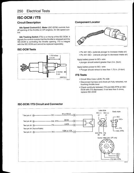

Don't have the manual in front of me so I can't remember how it is supposed to function. The ISC has 4 pins. Power, +actuation (more throttle), -actuation (less throttle), and signal return which lets the ECU know the ISC is touching the throttle bracket (when the ISC touches the throttle bracket, a ground path is enabled. Might get some wonkiness if the ground isn't working. Or the TPS could be out of range. While cranking, WOT TPS voltage is a signal to not run the injectors to clear a flooded condition. The noid light results seem to refute that though.
A 'tired' injector might have issues responding to low idle pulse widths, but the've been replaced.
The fact that is runs fine while not idling should rule out fuel/spark availability - at least initially.
There is a powertrain/troubleshooting manual that should have proper procedures to run through - but I highly doubt they have one.
What is the lowest rpm that the engine will run in idle? What is the position/voltage of the ISC/TPS at this rpm? What happens when you drop below it?
