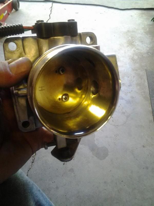

I took the factory Ford 65mm Cobra throttle body I had sitting on the stereo on the work bench and started playing with it. I opened the intake side to 69.5mm and rolled the edges like a trumpet, then polished the inside. I opened the back to 68mm. Yes, the blade is still 65mm, but I was just seeing what I could do with it. I will install it on the Sport next Saturday and see if I like it. I have a Professional Products polished t-body on the car now.
