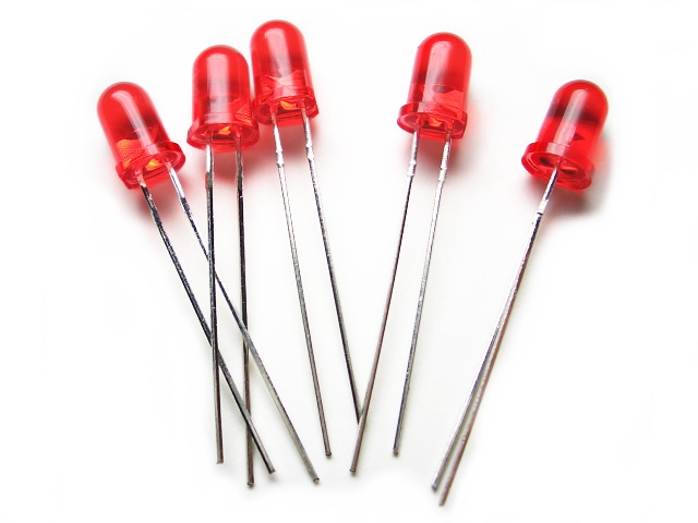

Wait! That's not LED, that's the standard silicon diode! LED looks like this. Longer leg is anode.
BTW, your chipset name is CD4001BCN.

Tom gave me some of these it's an LED light 12v rated will this work
