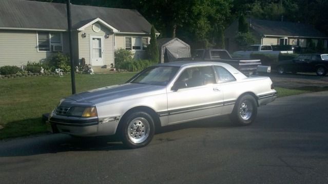

Quote from: slowbird;377475
well last week i traded my 88 thunderbird(turn key) for an 87 mustang roller :punchballs: just did'nt have it in me to cut up such a clean tbird. kinda sucks cause i regret it but guess ill be on the prowl for another bird come spring hopefully.. sorry had to rant
pic of the bird
pic of the stang, i am use it as a grudge car n for some street action
