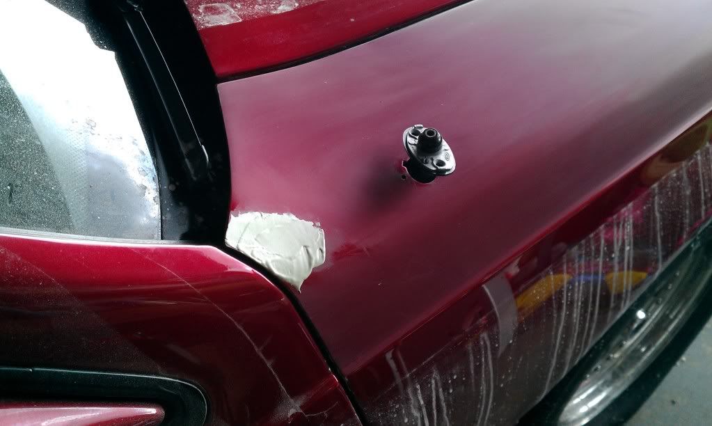

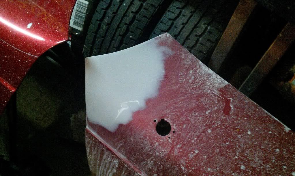

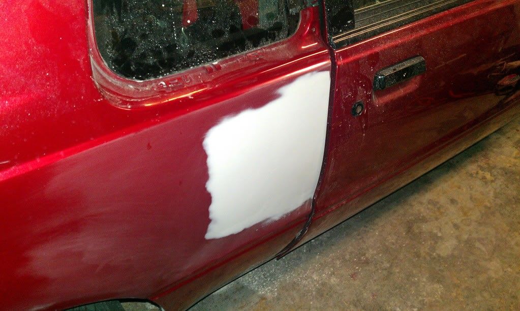

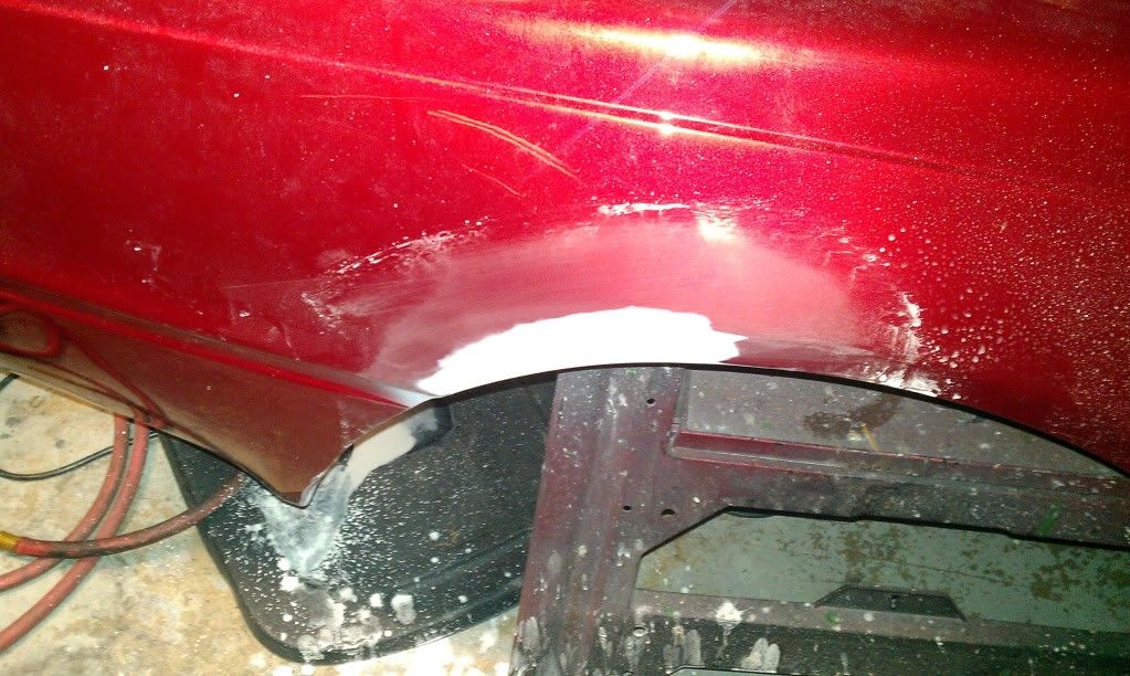

so I think I got carried away with the body work, I must not like driving my car.lol

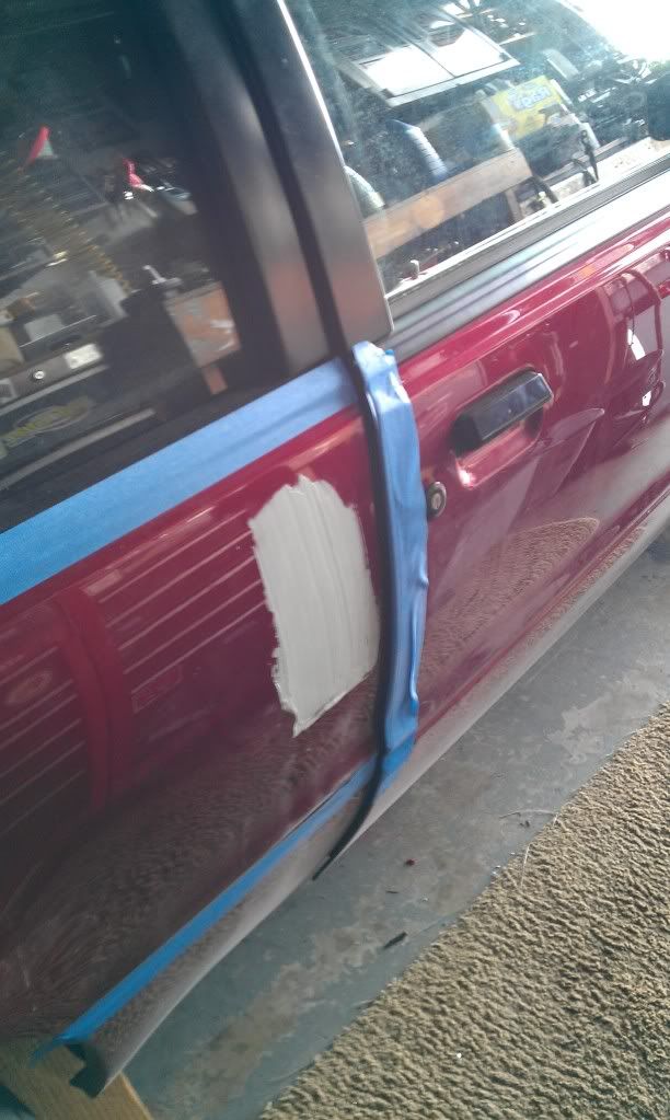

This spot I forgot I had to do
little rust in the door jamb

Oh my.  I guess while you are redoing the bumper, might as well fix the other dings. :)
I thought you have to put body filler on bare metal so it sticks and doesn't crack?
I f-up really bad!!!!!!!!!!! Picture update!!!!! 12/22
yeah,  I grind out the damaged area and then fill the area and sand down, saves you from having waves from feathering out the paint then filling, an old school body man taught me that trick. works like a charm, did the hole car that way

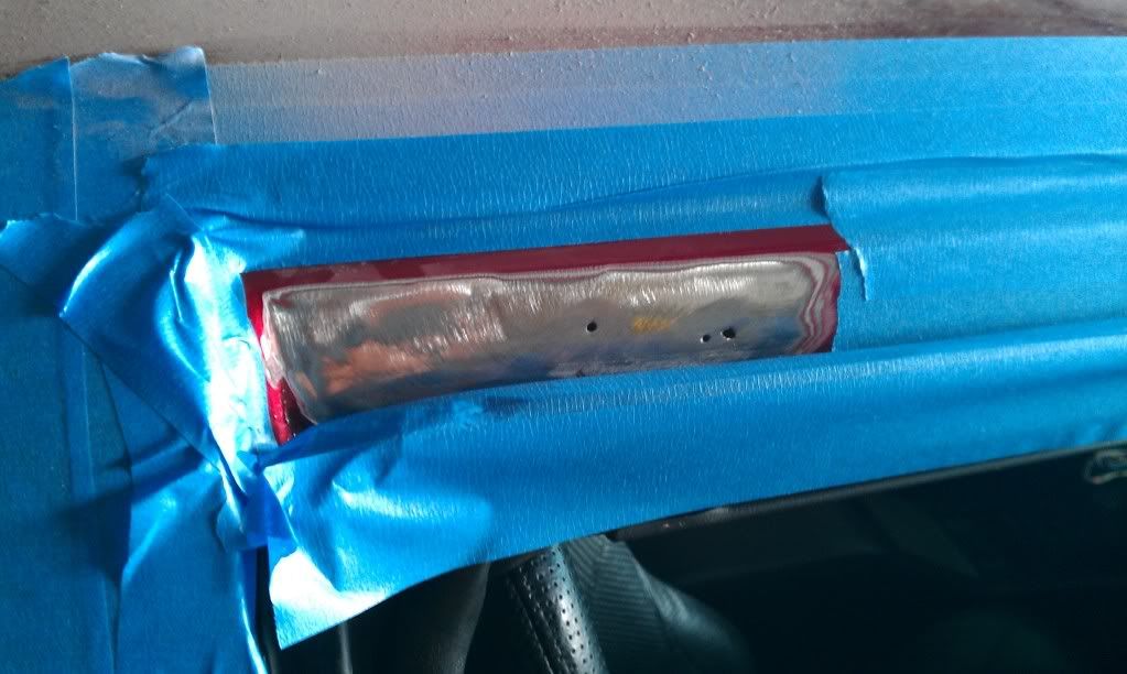

ready for paint

Quote from: 347Thunder;368025
my dad taught me that.. i tried doing it the other way and it's a real pain to get the 'edge' of the paint feathered down to eliminate the wave.. been doing it this way ever since.. takes a good deal of headaches out of getting the right 'form'.. she's looking good so far!
