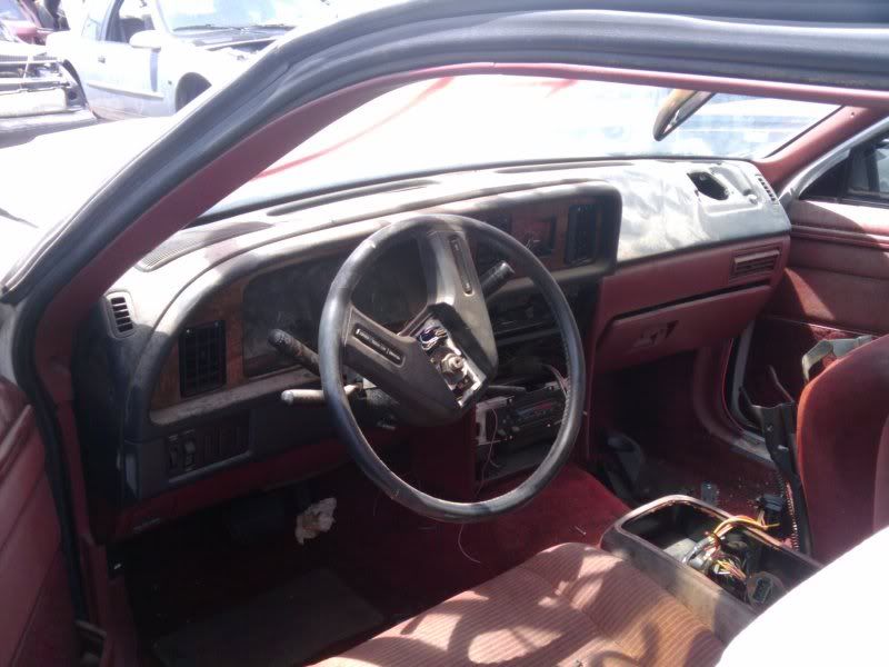

I'm not trying to argue at all but here are some pictures of the cars and the interiors from the yard.  These aren't all of them just the ones I took with my camera as opposed to my phone.  Again, just backing up what I posted, not arguing.  Also, now that I'm thinking about it, my 86 XR7 had an aftermarket cruise lever, so only 2 of my 86s had the round.  Edit: Now that I think about even more, the turn signal was aftermarket but it had the round wiper lever and I don't think they mismatched them at the factory.

I thought too the 83-86 cars had the square stalks but you sure have a lot of pictures to show otherwise. I know the 84-86 Mustang SVO uses the square stalks.

My experience has been the opposite. I can't recall ever seeing a square style lever in any '85 or newer car.
I just went through all of the photos of the cars I have saved on my computer and still no square levers. I thought it might be a trim level thing but even cars that have next to no options still had the round one.
