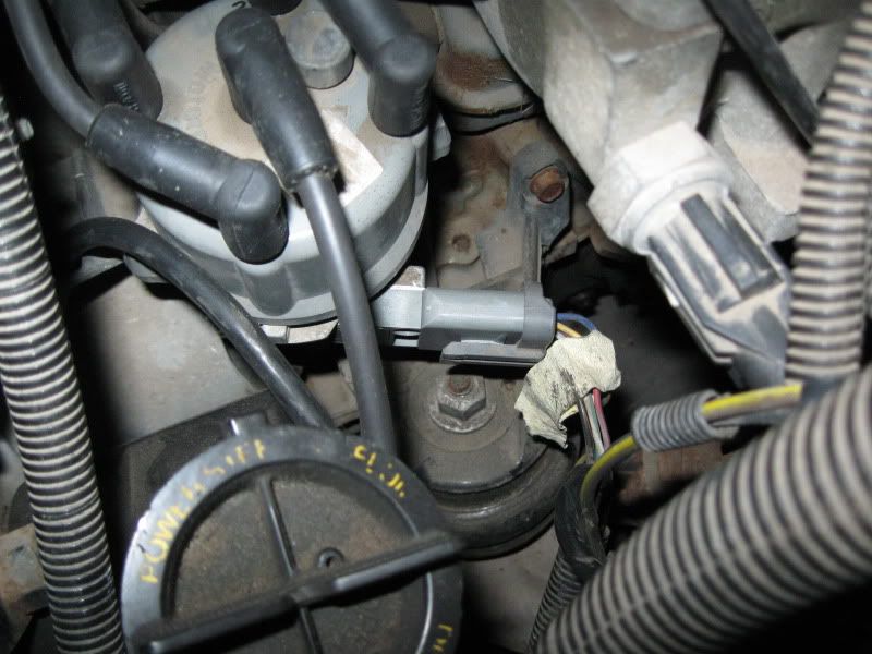

Fox Salvage-Can you put up a picture of the module on the distributor? Is it the part that is plugged into on the side of the distributor?

Yes, the ignition module (usually called the TFI) is plugged into the distributor.
Here is a picture of it on my 86 and then a link to what it looks like off the car (Autozone link.)

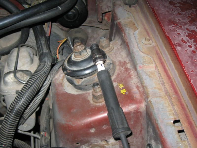

To check for spark, pull a spark plug and wire and lay the spark plug on one of the shock towers (with the wire connected)  Crank the engine and see if it sparks.

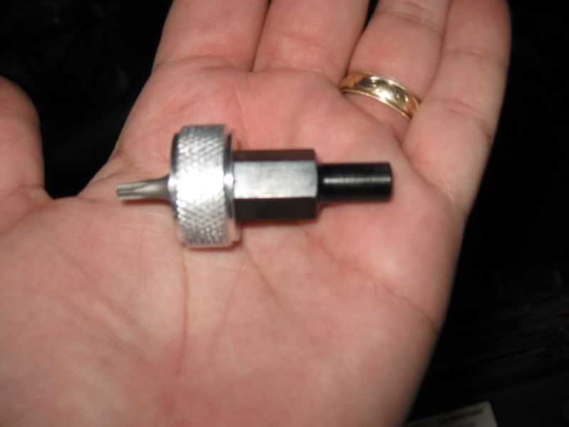

If changing the TFI, you may need the special TFI tool pictured below.

Ahh gotcha! Is that a special tool or just a small philips head on a socket drive? because i have a lot of tools my dad gave me so i could possible have the latter lol

Actually, the side you need is the other side.  It is a really thin walled 5.5mm.  A regular 5.5 won't fit.
Only $5 at Autozone.
http://www.autozone.com/autozone/accessories/OEM-Ignition-module-wrench/_/N-25fu?counter=0&filterByKeyWord=ignition+module&fromString=search&itemIdentifier=2362_0_0_

Ok just finished checking stuff and i replaced the TFI and checked spark like Loaded87IROC said to and it still does the same thing. I took a video of what it does if i can email you? I don't have a youtube account to post it. I will try and change the fuel filter this week, possibly tomorrow.
