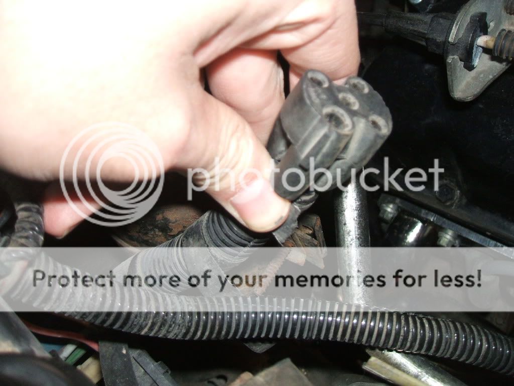

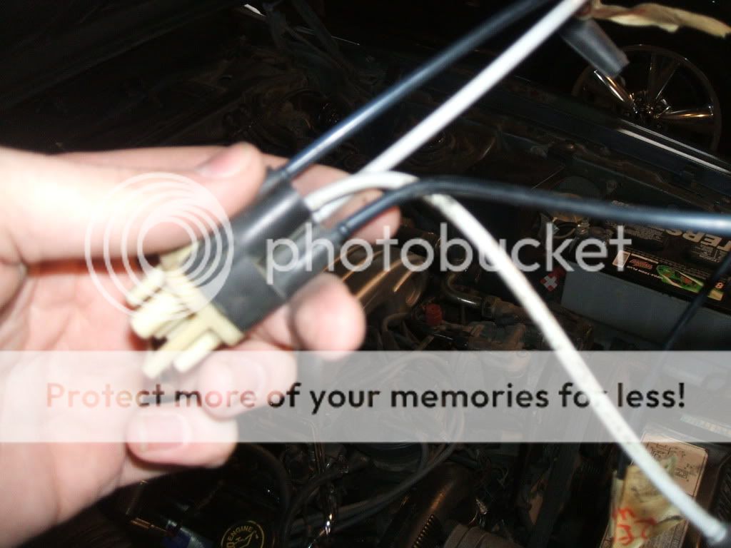

checked the 02 sensor wires and they look to be routed correctly. I really don't think these could have gotten swapped around on us, but I could be wrong.
Oh it's VERY easy to install them backwards/on the wrong bank.  Get a wiring diagram with color codes to double check as each side has different colors.
Finally ROUGH IDLE may be cured!!
Quote from: V8Demon;340642
Yeah I was checking that last night and saw that they were different colored wires.  I will do a search online for a wiring diagram.

On a side note, I just got home from work and checked the 02 sensor wires.  According to a schematic I printed off the internet the drivers side should have a blue wire while passenger side should have a green wire.  Guess what?  My drivers side has a green wire and my passenger side has a blue one.  We may have a winner here.  I will switch sides tomorrow after work and see what happens.  Keep your fingers crossed!

Well we may have a winner.  Yesterday after work I pulled the 02 harness (which is a real beotch for a guy with big hands btw) and swapped it around.
Started the car up and it settled down into a real nice idle.  Took it for a quick spin and no miss under load.  I'm not gonna start jumping up and down yet, I want to put a few miles on it today and see how it acts.  But my nightmare MAY be over.
Thanks for the help guys!!

02 wires were on the wrong sides.
