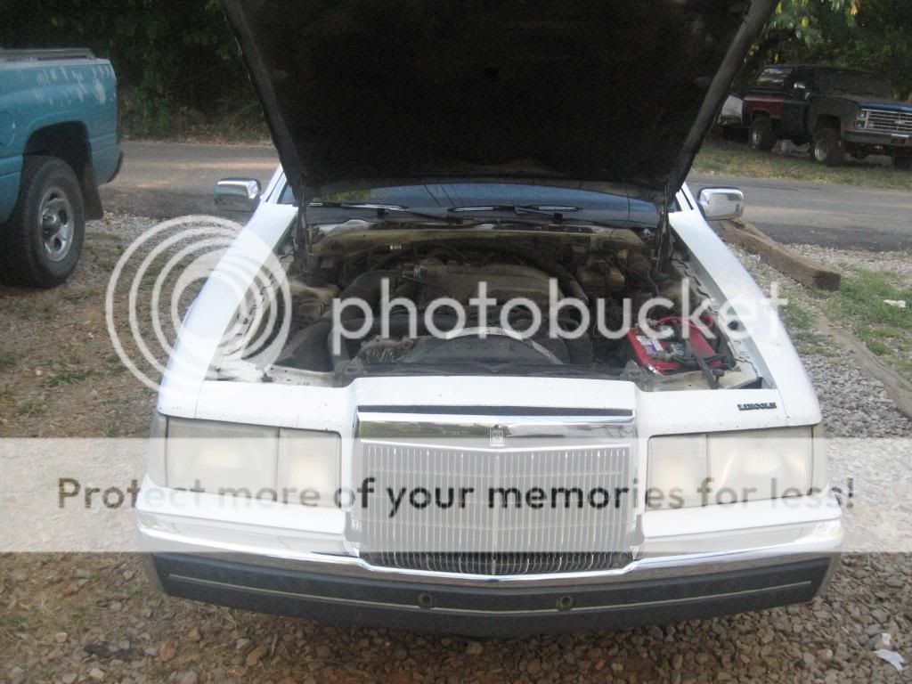

Got a lot of work done on the Mark in the past few days. Got my power windows working, changed the oil, replaced the valve cover gaskets, plugs,wires,cap and rotor,new MSD coil, fuel filter, air filter, changed tranny fluid/filter (which was surprisingly clean, didn't find a trace of any metal shavings in the pan) got my power assist braking back, and refilled the air ride via the shrader valve on the compressor and turned the air ride off and it hasn't leaked down a bit! (Still more work to do to get it functional, but at least it's off the ground LOL).

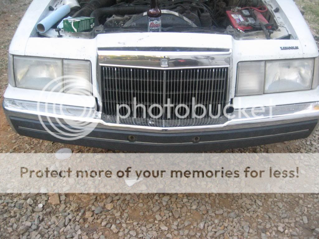

I also polished my lights. I used the 6 dollar turtle wax kit at wal mart, and I am pretty impressed  with the results for the price.
Before:
After:

How much power does the beer can add?
My new LSC!!
Quote from: thunderjet302;339205
Thats for wet sanding, instead of using water :mullet:
My new LSC!!
Alcohol injection.....:hick:
I didn't realize the bottle was in the pic 'till after I posted,,,,,

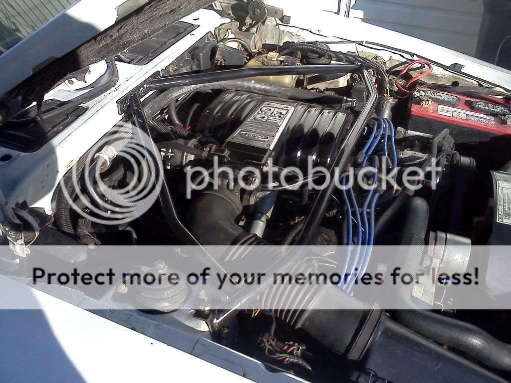

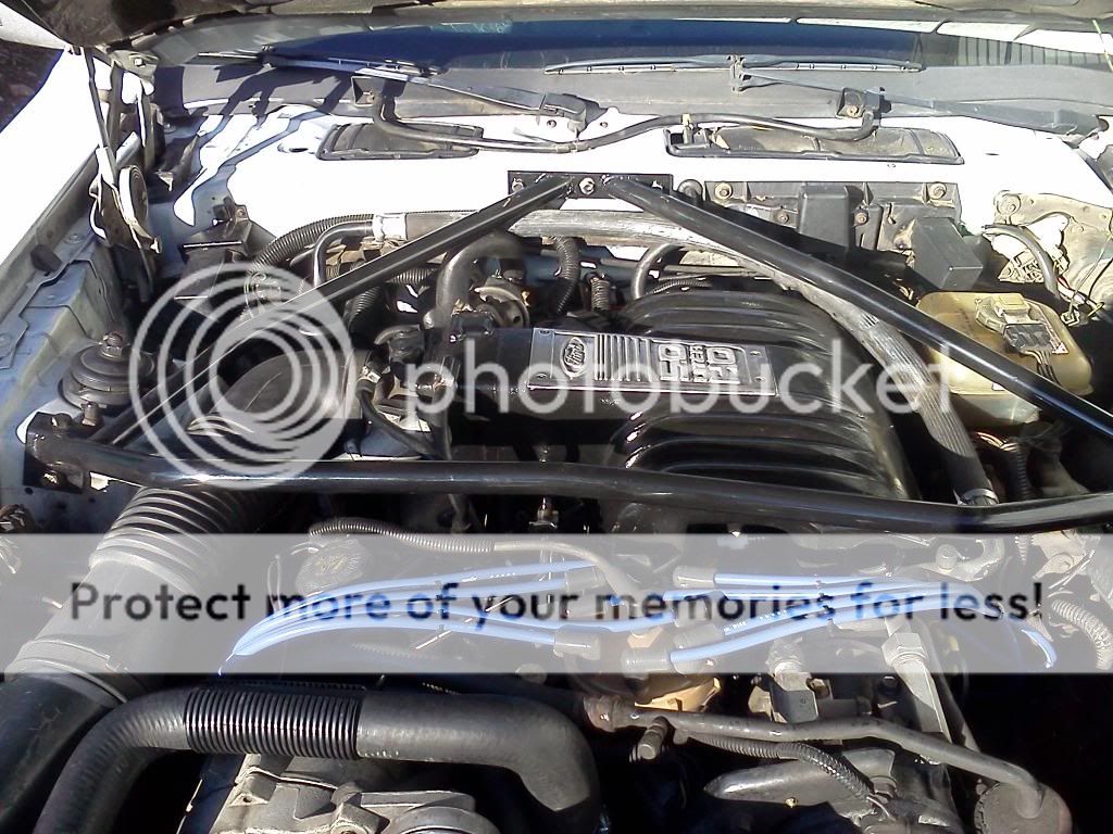

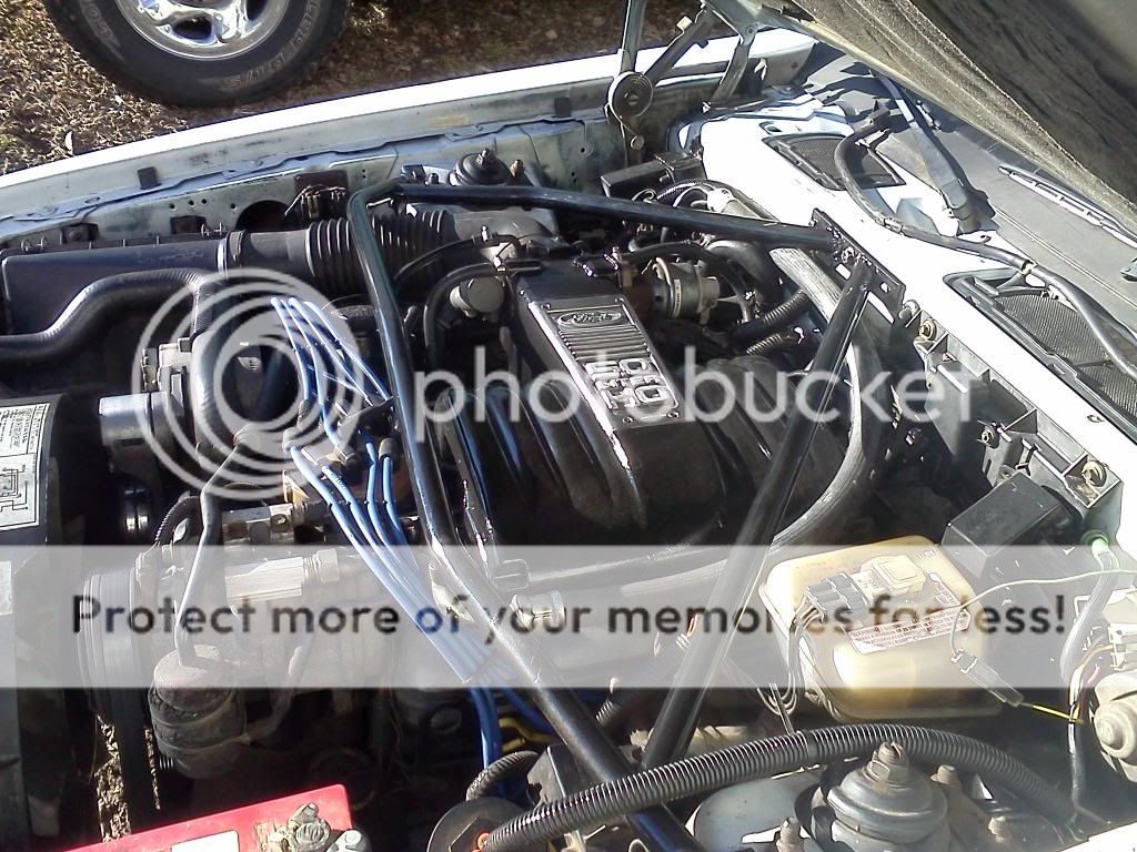

So the Mark has come a long way since I brought it home. Air ride is fully functional, brakes (minus the ABS) are fully functional. I have been doing a little bit here and there, it gets hard to do anything major because it is still my DD for another month or two.
I also painted the intake and installed a strut tower brace (done a few minutes ago..). I still need to touch up some areas (on the brace) and do away with the hideous coil wire (when I replaced the wires the coil wire in the box was too short) and clean the engine bay some more, but right now I am pretty happy with the way it is coming along. Let me know what you guys think... good or bad!

Looking Good bro !!
