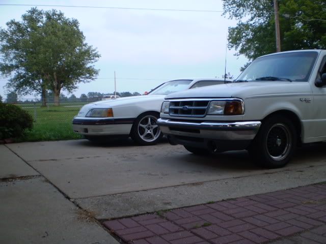

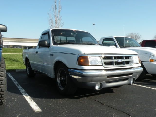

I 'think' there is a spray application to do the tint but it's probably a trial and error procedure to get the look you want.
VHT nightshades
this is two VERY light coats plus three coats of clear on my ranger front marker lights. the stuff gets dark with a quickness, so be careful how many coats you put on.
another shot in full sun
TC Freshen Up - WIP (pics!)
I might have to try that. It goes on the outside? What type of clear coat do you use (Acrylic lacquer, etc)?

yes, on the outside, its rattle can tint. and yeah, im pretty sure i used lacquer clear.
