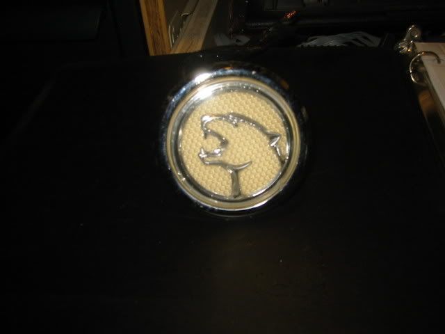

The problem I keep running into is finding white EL panels that are also white when they are powered off.  All the white ones out there are salmon-colored when off and that will not suffice.
EL Coach Lamps
Like this?
EL Coach Lamps
I've thought of a few ways around it but would like to find white parallel electrode EL sheets that are also white when no power is applied. I've found plenty of pink ones that are white when powered but pink when off.  I suppose a very thin piece of frosted Lexan or something like that could be placed over it but I haven't tried that yet because I wasn't home most of 2008.
I bought the last original inverters from the manufacturer that made them for our cars in the '80s though.

C2g,
All of the OEM coach lamps I have seen indeed have an off white opaque diffuser lens covering the foil pack.  Seems like this would solve the off-pink problem.
