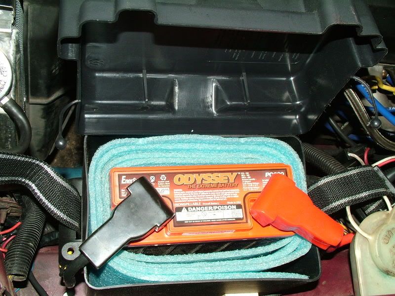

I was going to mount mine in the trunk, then I decided to get one of these 13# Odyssey batteries
I still have the aluminum box and hardware/cables etc. if you are interested.

Cougar, how long have you had that Odyssey, and is yours a DD?

I've had it for a couple of months now - the car is a weekend warrior. So far, so good...

Do you put a trickle charger on it?

No need to - the SLA batteries can hold a charge for more than a year. I may put a trickle charger on it in the winter time just in case.

Not sure if you were asking me, but Hawker makes the Odyssey batteries.
Anything you might need to know about the Hawker/Odyssey battery is here -> http://www.stealth316.com/2-dynabatt.htm#g16ep
A good site with specs for the Odyssey batteries -> http://www.odysseybatteries.com/index.htm
There is tons more info at the two sites I listed. Full up-to-date info on the Odyssey is in the Documentation section of the 2nd site.
