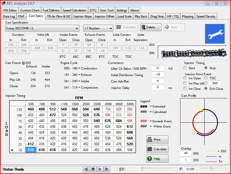

Here is a shot of EA on the cam tab that helps you decide on injector timing:

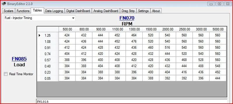

Here is binary editor - this is my actual injector timing:
