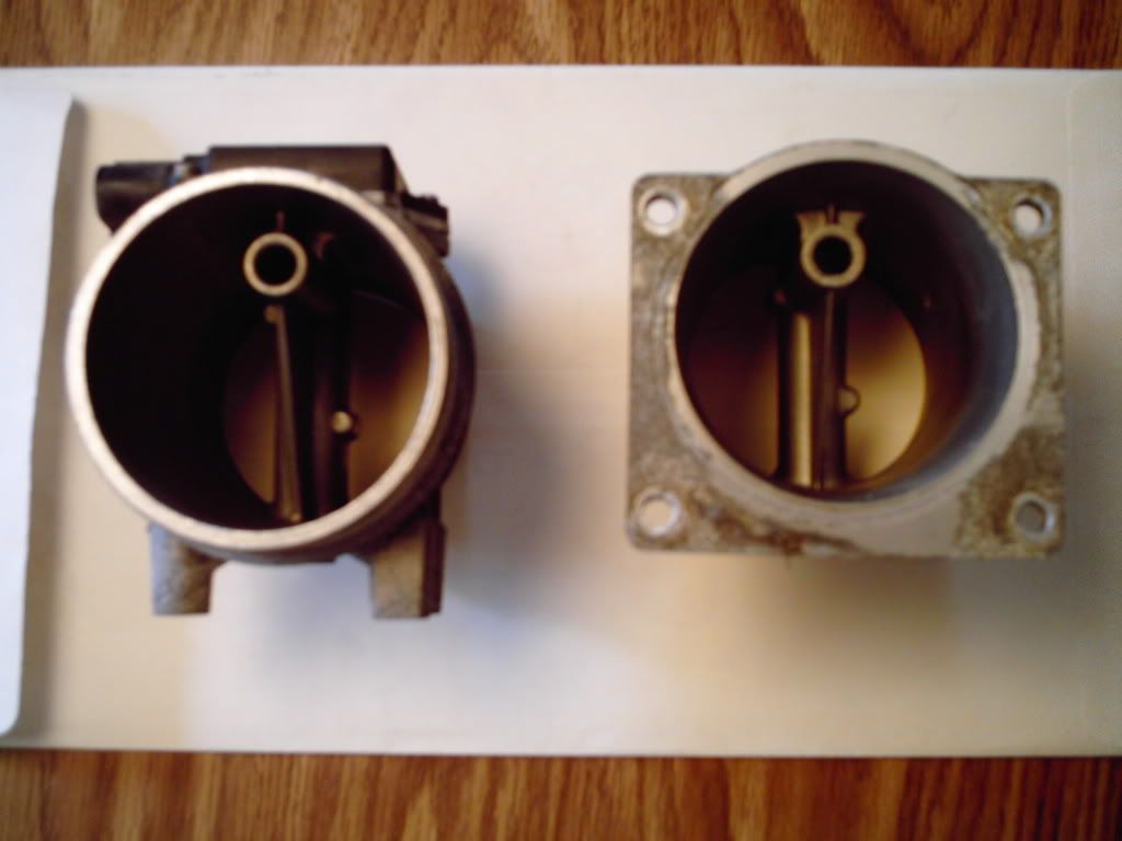

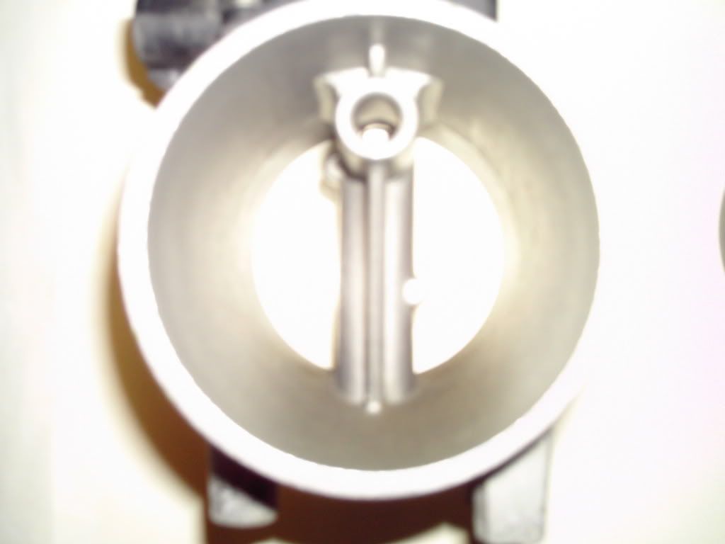

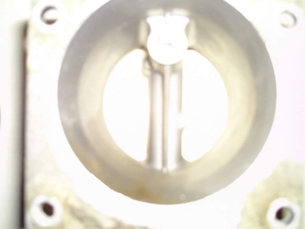

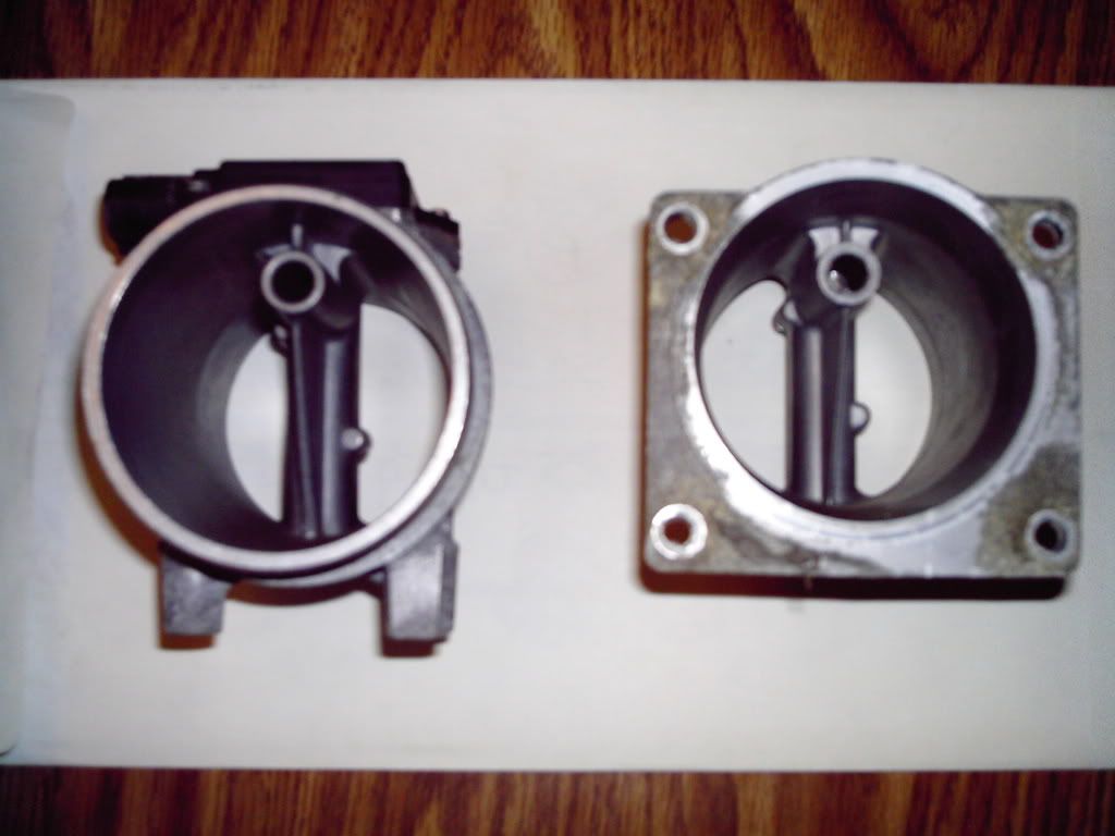

Ah some more fun with pics. I took pics of a 70mm 94-95 Mustang MAF vs a 93 Cobra/T-bird SC/94-95 T-bird LX housing. I'm going to try to run the 94-95 Mustang housing with the 55mm electronics swapped in first and if it runs good I'm going to try the T-bird housing with the 55mm electronics swapped in to see how it does. Should be fun :hick:

Ok so I'm now running a 70mm MAF :D . I'm using a F2VF sensor and housing from a 94 Crown Vic Interceptor (same as a 94-95 Mustang MAF) with the  ground down. I tried the 70mm MAF from my 95 T-bird first (the MAF I used in the comparison pics) with the F2VF electronics from the Vic MAF (since the stock 55mm MAF electronics will lean out in a 70mm factory MAF housing) and it ran like poo. Turns out the T-bird 70mm MAF has a slightly longer *sampling tube* which the F2VF sensor doesn't like. The car feels stronger in street driving (so the 55mm MAF must have been restricting power somewhat) but I still have to take it to the stip to see if I picked up anything. So if you have a MAF converted car that's still running 19 lb injectors this is a cheap (I spent $30 for a complete MAF and one extra housing incase I screwed one up grinding ;) ) upgrade for a slightly bigger MAF. I'm the second person here to do it and yes it does work.

Yep by  I mean where the front of the meter was bolted to the stock air box. I just cut it off with a hack saw and ground it down on a bench grinder so it was round and fit in the factory air tube.
The *sampling tube* on the 94-95 T-bird MAF is about 1/3-1/2 inch longer. The bores on both meters are the same but the extra length of the tube probably changes the signal that the F2VF sensor is expecting. I would *probably* work if the sample tube was cut down to match the 94-95 Mustang housing (easy to do with a Dremel) but since I was trying the housing off my 95 I didn't do it. It would have cost me $4 to get another housing from the junk yard so I just used the Mustang/Crown Vic housing since I had 2 sitting around.
