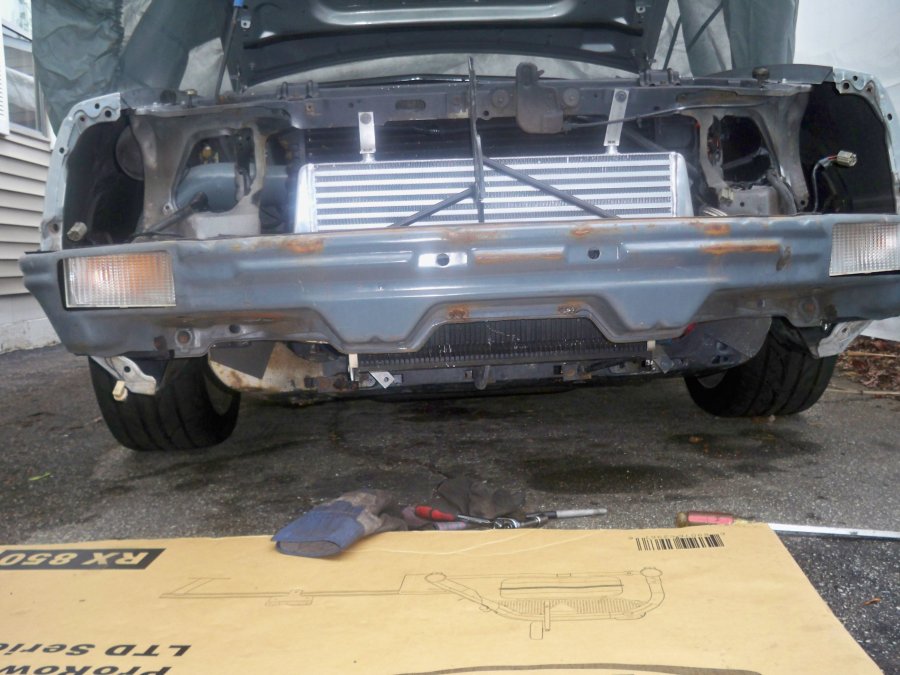

Now yesterday, I was feeling froggy and decided to do this to the car...

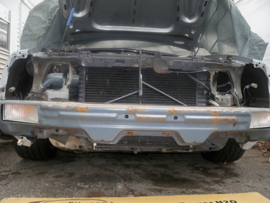

Because I was finally getting around to doing this...
You really can't see the bottom of it, because it's obscured by the bumper and oil cooler, but the inlet/outlet are bottom-mounted.

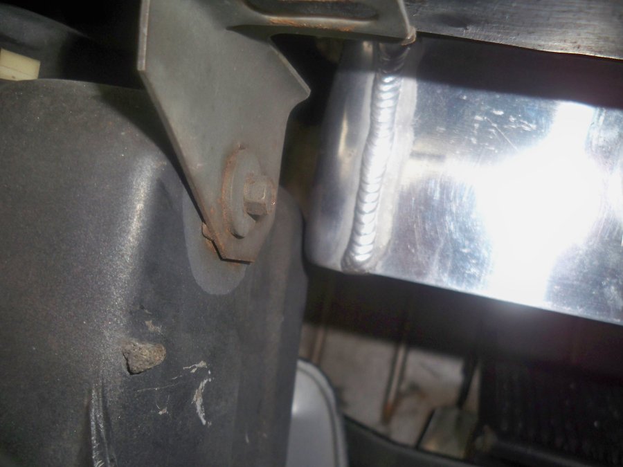

This pic shows how close it is to fitting between the headlight buckets in the header panel.  Somehow I eyeballed the centering placement on it, and there is basically a paper's thickness of room between the IC and the header panel.  I'll probably knock the header panel down a touch when I get ready to remount it again.
Now it's a matter of plumbing things.  I need a bunch of 2-1/2" tubing, and perhaps a couple more couplers.  I have a bunch silicone couplers, 45's and 90's I got cheap a while back, and now will put them to good use.
Being the contrary S.O.B. that I am, I'm not running a rotated intake, so there may be a long run of IC tubing, but it really won't matter when it's all said and done.

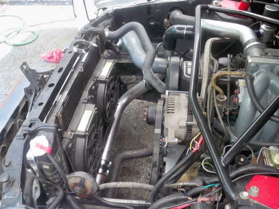

You gonna run the compressor outlet over the v/c, or clock the housing and run the pipe low?
Your air filter location ROCKS! same as mine :bowdown:
Chuck's '83 TBird
Reply #112

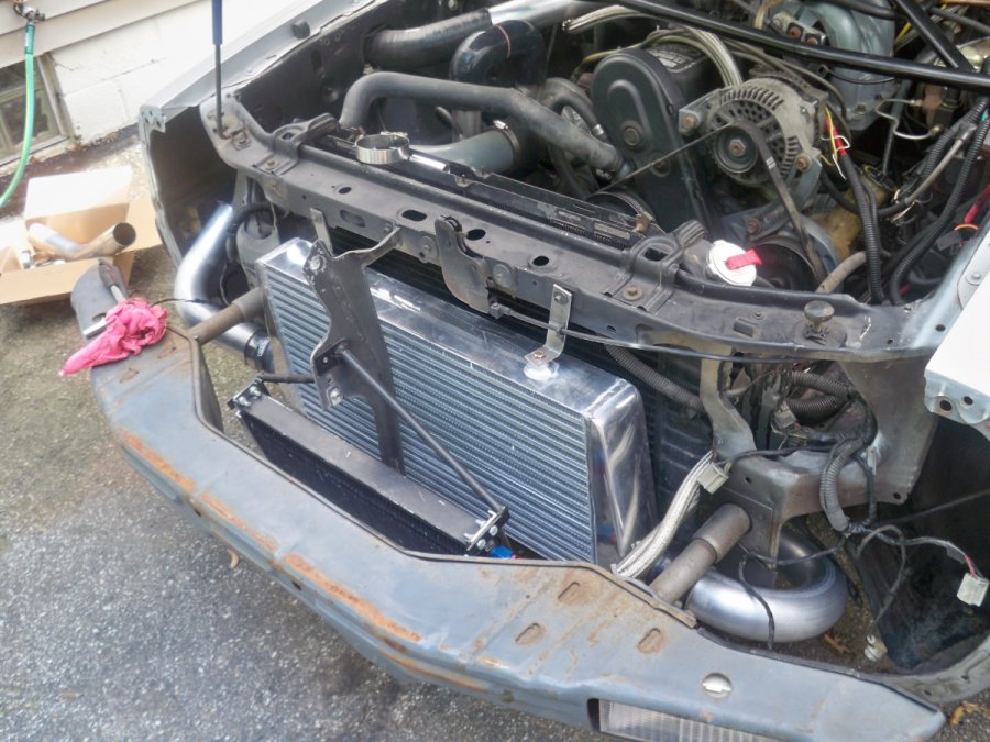

Actually the best way it looks to me is to run a silicone "U" off the turbo as it sits.  I looked at clocking it, but it didn't make me happy.
On the driver side, there is a "U" bend that comes out of the intercooler and wraps around the core support, and runs right on top of the lower rad hose brace. It will run low behind the rad, and then shoot up to meet that silicone "U".

Ok, got the final mock-up of the IC tubing done this past weekend.  Had to wait for a couple pieces to show up (they sent me some wrong stuff).
The parts are now off at the powdercoater (for silver) and when I get them back, I'll be able to button this all back up and get the car on the road again.
