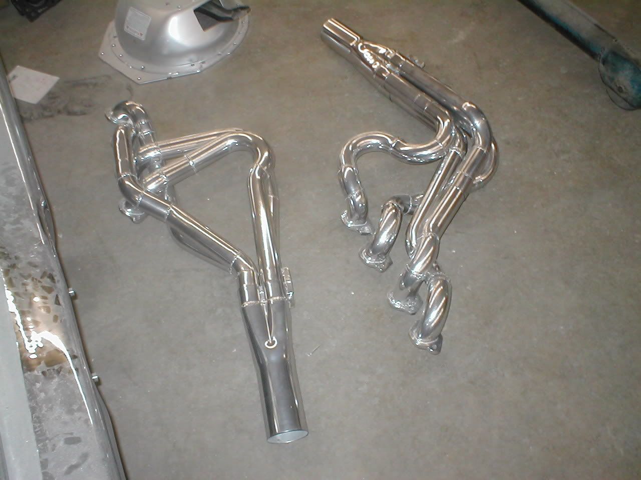

what headers do you have on your truck?
My F-100
Reply #108

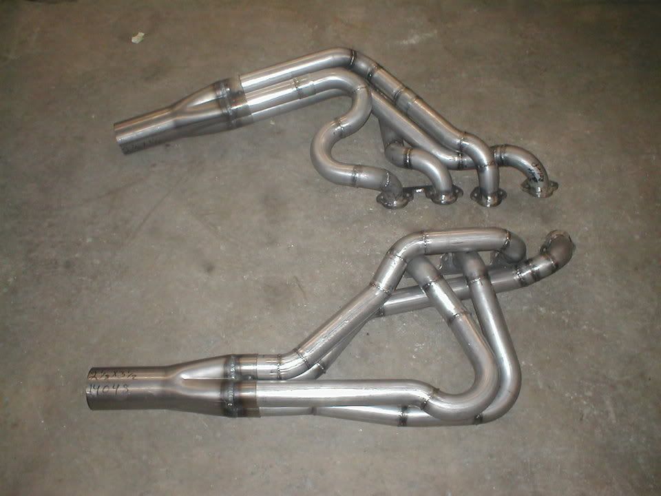

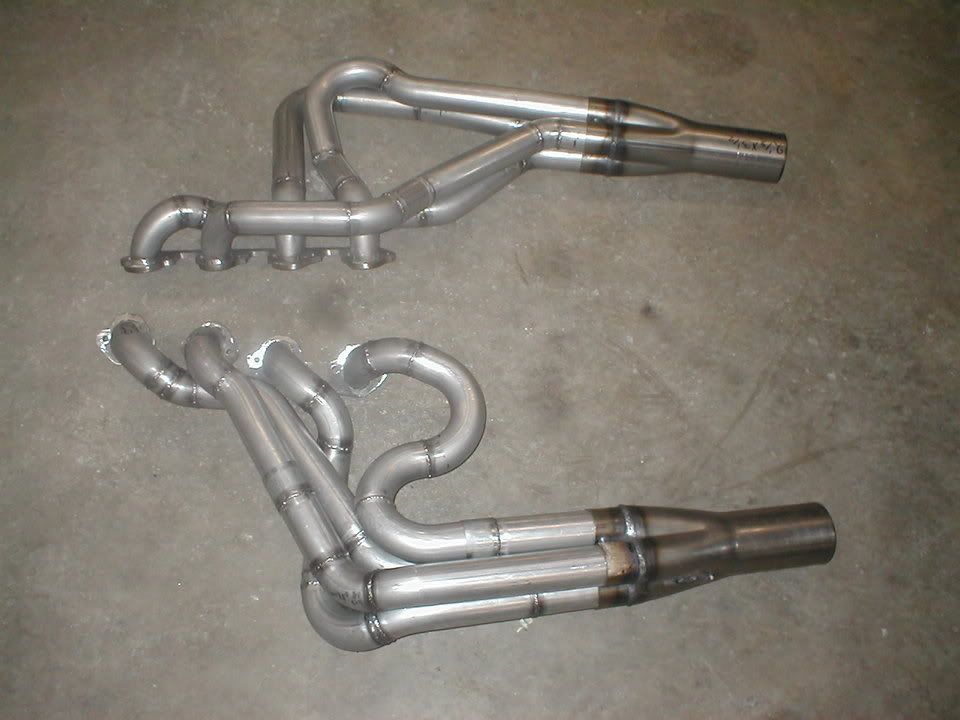

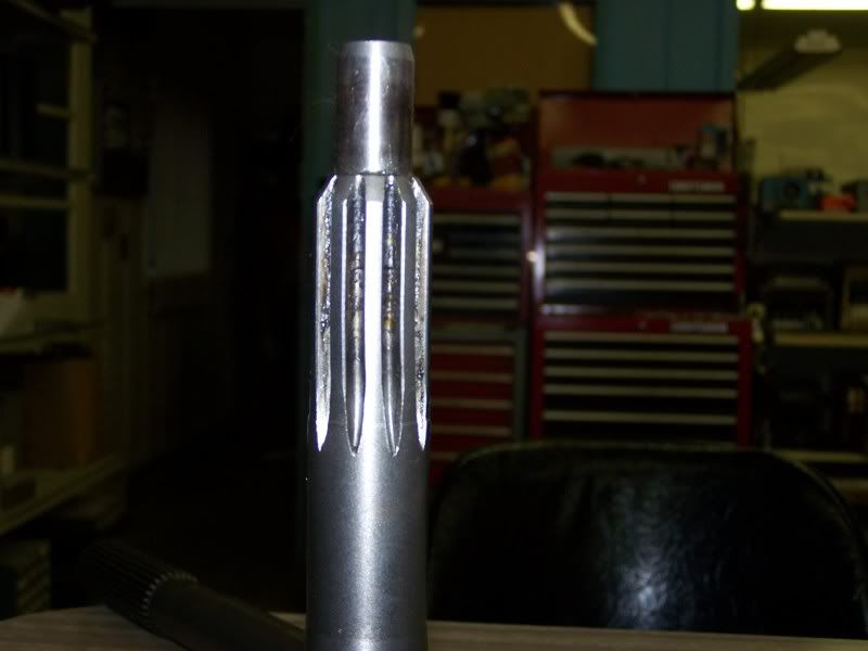

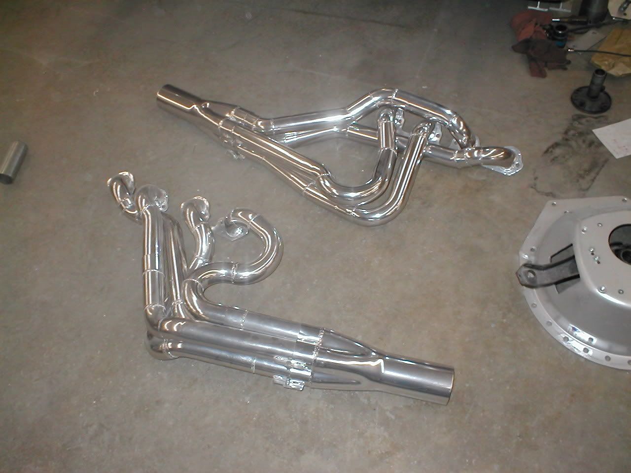

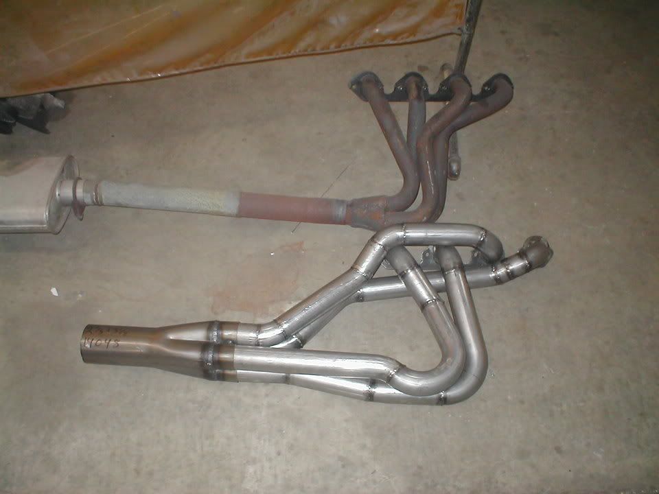

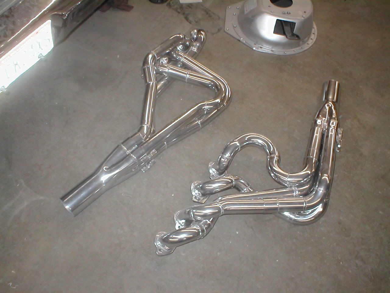

you wont find em anywhere cause I made them.  2 1/8 primary equal length.  Took me a month to make them.  I got my toploader for $100:D only cause dad sold it to the guy I got it back off of and he works for us.  Guy was going with an auto if he would EVER get his 64falcon done.  I ran it quite a while on the 43 year old bearings, and finally lost one.  When I pulled it out to fix it, I found out the input shaft was twisted
We'll see how long the rest of the trans lasts now because I just put in a McLeod dual disk clutch.  I have replaced pretty much all the gears in it because it was a close ratio and it didn't work too well with the 5200# truck.  Still using the stock 44 year old syncros:rollin:
Heres some pics of my headers
top one is an old header.  Dynomax for a 73/79 ford f150 1 5/8 primary
My F-100
Reply #109
man those headers are bada$$
