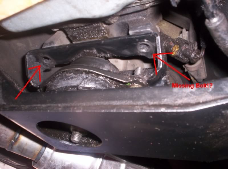

Ok, after calling Ford and getting nothing but..."Well....you see son, we just don't have information like that anymore...and you really shouldn't be servicing this car by yourself"....I'm now turning to the forum for help:
I need to know what size bolts fit in the following mount that holds up the Transmission:
Thanks in advance if any of you can come up with the correct bolt size. Ford Couldn't.

not sure of the size but lookin at the pic the right one looks broke off.

Well, after 8 hours, I was able to change out the two bolts. The cramped quarters made things very difficult. The bolt on the drivers side went in with no problems, the passenger side bolt however....the thread was stripped. Nightmare. That's what consumed the other 7 1/2 hours.
Seems to have fixed my floorboard vibration when the A/C is turned on. Things seem smoother.

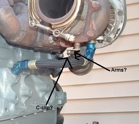

Have you checked the WGA and flapper to make sure it's closing all the way yet?
NO.
Take the c-clip off the WGA arm that attaches it to the WG flapper on the turbo outlet elbow and see if it's keeping the flapper from sealing all the way.  Here's a hint...if you take the c-clip off and remove the WGA arm and close the flapper with your finger, the WGA arm should not be able to reach the stud on the flapper.  Technically you should have to pull on the arm (or apply some air pressure to the WGA to move the arm) to get it to seat on the flapper stud when it is fully closed.
We told you to check this weeks ago and you haven't.  As usual.

Apologizes, but I have no idea where that stuff is. If you have a diagram or something to show me where this C-Clip and WGA Arm are, that would be wonderful.

You'd think you would have looked for this yourself as many times as it was mentioned to you.
You can see the flapper arm sticking out the bottom of the turbo.  The WGA is the round thing partially obscured by the drain line.

Thanks for the image. I see the WGA, and I think I see two "arms". Which one is which? And where is this "Flapper"?

The flapper is up inside the turbo outlet....
Your IHI is a little different in that the flapper is not in the outlet elbow, but they function the same...
