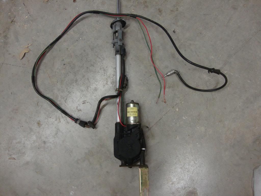

Purchased a power antenna from the local crushing yard today.  Donor was a 88 XR7.  I want to ensure it works or I'm taking it back to the yard for my money.  How can I bench test to ensure it works?  I grounded the green wire to the negative term on my battery and placed the red wire on the positive terminal...no response.

Reverse the wires to battery hook-up. Reversing the wires will make it change directions. (up/down).
How Do I Bench Test Power Antenna?
I'd ground the mounting bracket. Then try one wire at a time.

For down, the switch puts 12v on the green and ground on the red.
For up, the switch puts 12v on the red and ground on the green.
Update:  Operator error.  I wasn't making a good connection at the battery until I wired some alligator clips.  Thanks for the wiring diagram and advice.  The motor works great.
