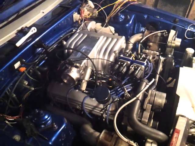

That is pretty F'ing sweet man!!! Tell me this is in your car.
Darren
New Coil Pack Ignition works
it is. Andrew has been around for a long time. I remember the car being superchaged way back when. id guess 2002 or so?
I think there is a boost leak lol
Jk nice set up
Never been supercharged but it used to be a v6 automatic and then I put a 5.0 5 speed set up out of a 1991 mustang about 2004. I put the twin turbo set up on it about 2006. I was using the Anderson Ford Motorsport PMS for tuning but it was garbage. I installed the AEM in 2008 and It was much better for tuning but it never worked well with the py Ford TFI module so in fall 2010 I parked it and took out all the factory 5.0 engine wiring and started from scratch building my own wiring harness for the AEM and incorporating coil packs and a crank and cam sensor which never came as a factory option. Best thing I have ever done for the car! The AEM works perfect with a cam sensor and a 12 tooth crank trigger wheel and coil packs. The coil packs are just standard GM Coil packs and are inexpensive good coil packs that still use the factory style plug wires.

i smell the makings of a tech article here, complete with wiring diagrams., and pictures. what say andrew?

Maybe at the end of the semester I could put something together. In my senior year of Mechanical Engineering so I don't have to much free time during the semester.
