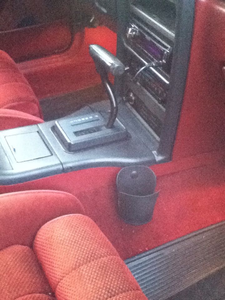

i finally got a cupholder in my tbird. i couldnt find what i was after for a long time. finally, my mom got a new electric wheelchair, and it came with this simple cupholder attached to the armrest.      she didnt want it, soooo. one 1/4 drill bit later and a christmas tree push pin, i have a cupholder now. it works well i think.
-pete
july/88 turbo coupe auto

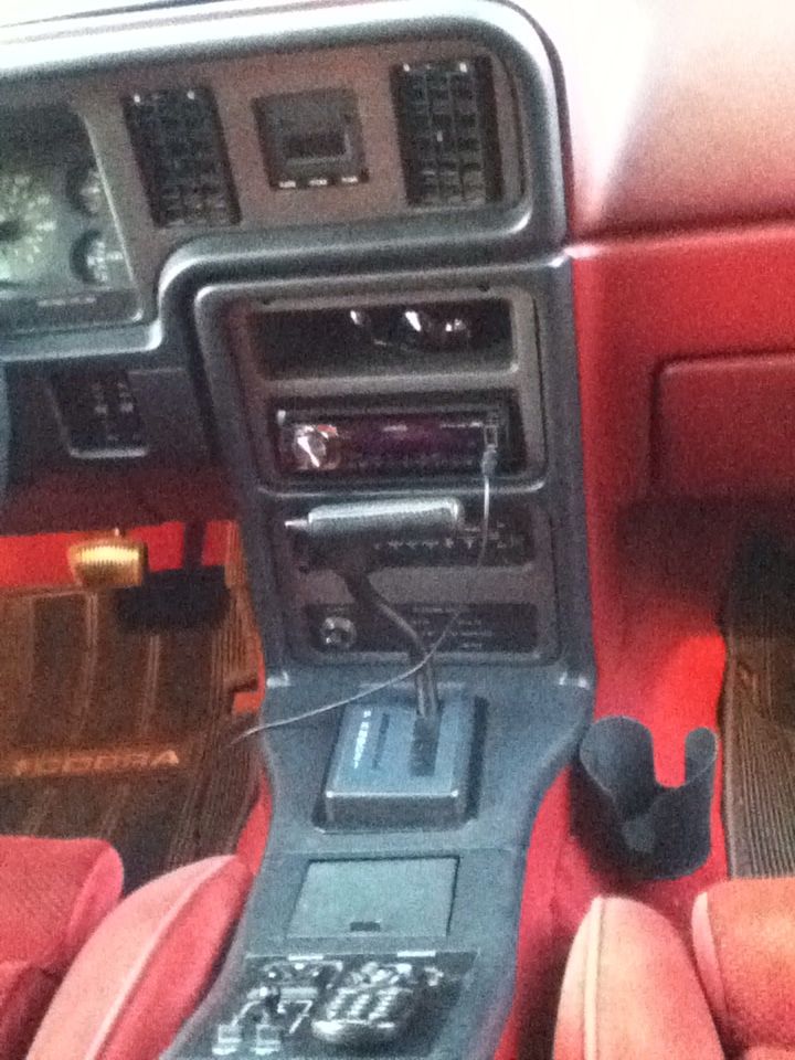

Somewhere there are pics on the forum of my cupholder mod. I dremeled a cutout next to the lighter and put in one of those pop-out in-dash cupholders (Toyota JDM, had to special-order it). It's only possible if you have a column shift, no sentry lights next to the lighter, and the small ashtray in front of the window switches (basically a blank area next to the lighter).

Here's a pic that shows where my cupholder is. It's spring-loaded, you push it in and it pops out. It only holds a single cup, but it does the job. I had to slightly mod the sleeve to let it slide out an extra 1/2" to clear the lip below it, but that was really easy. The part is a JDM in-dash cupholder for a Toyota 80 Series (Land Cruiser).
http://shop.cruiserparts.net/index.php?main_page=product_info&products_id=113
There are others, but this has possibly the best fit for the panel. There's a 4Runner one that holds two cups but the front panel is angled so the fit is wrong.
