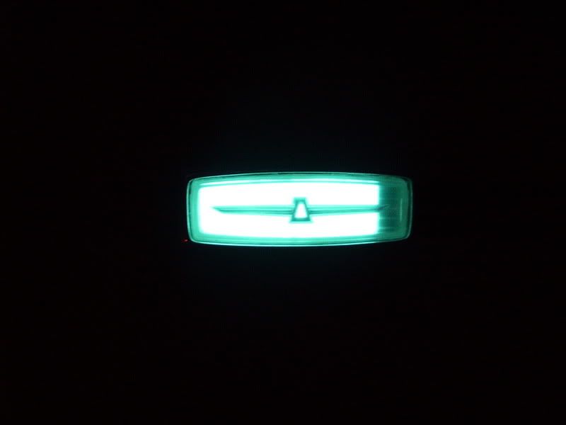

I'm interested in either at this point. I've repaired one of my emblems. So far what I've discovered, is that they run off 12 volts. That 12 volts goes through an inverter, which takes the 12 volts DC and changes it to a very high frequency, but low amperage AC signal. The inverter is what makes the humming noise. That AC signal is what goes to the panel and makes it light up.
With my emblems, I had one of my inverters working, and the other was dead. I replaced the electroluminescent panel with a new one, and I was able to make it light up again. Only...blue. I assume they lit white/yellow when new.
My main goal is to be able to rebuild the inverter. I need to know how to make an identically functioning circuit as the old inverter using new components. I know I'll never be able to make it as small as the original, however. The original inverters aren't much bigger than a pencil eraser. They're also covered in a black rubber substance, probably to reduce the amount of hum that makes it into the car. This also makes it impossible to get to any of the original components that make up the inverter circuit. I know it uses an inductor and some caps, I doubt it uses any solid state circuits.

How did you seperate the lens without it breaking? One on my 83 still lights white, the other just hums. And on my 80 both sides that say silver anniversary light white, its a bigger piece but I would imagine the same idea

Very carefully :p
