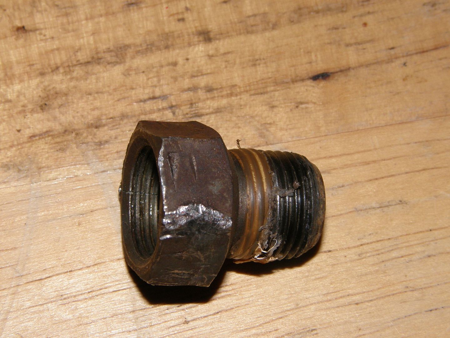

Yep, need one of these. For my '86 TC's T3. It's pretty obvious why! Anybody have one laying around? PM me price shipped. Thanks!
Turbo coolant inlet fitting.
hardware store, they are standard pipe thread with a flare.  well the male part will be pipe thread, not sure on the female part....

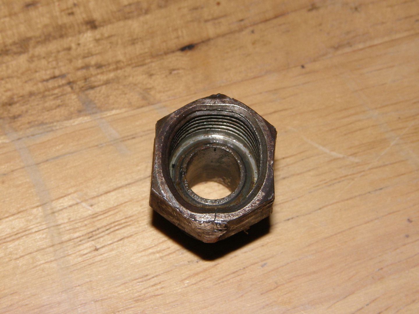

I keep hearing that!  However, I've been to a couple of different hardware stores and nobody has anything close due to the inverted flare inside the female end.  I NEED this piece!  Help!
You might try a place that makes hydraulic hoses, they have all sorts of fittings.
1988 Thunderbird LX  557/C6 project. UPR tube K-member, A-Arms, Strange 10 way adjustable coilovers. SN-95 spindle,brakes. Manual rack, bump steer kit.  MM castor/camber plates, Dynatech 2 1/8 swap headers. Quick 9" 35 spline Moser axles,CHE lower c arms,
I got it! Thanks everyone! As recommended, I went to a hydraulic shop. $5 did the deed. FYI.......Female side is 1/2" inverted flare and male side is 3/8" NPTF Male pipe thread.
