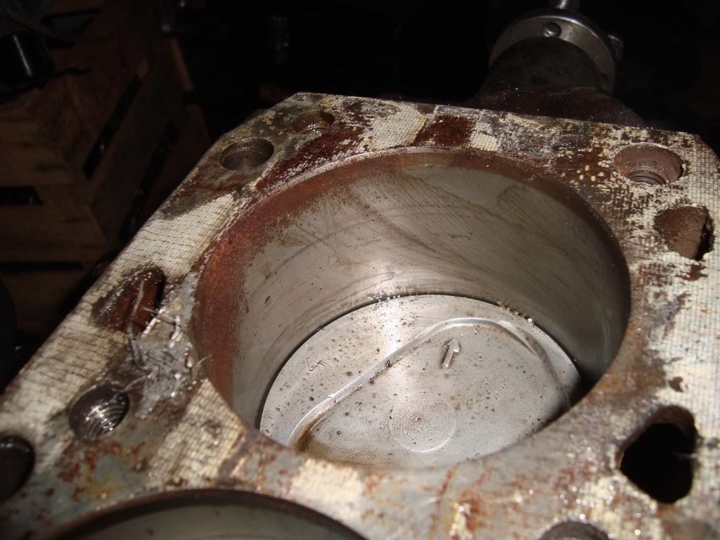

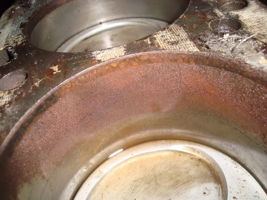

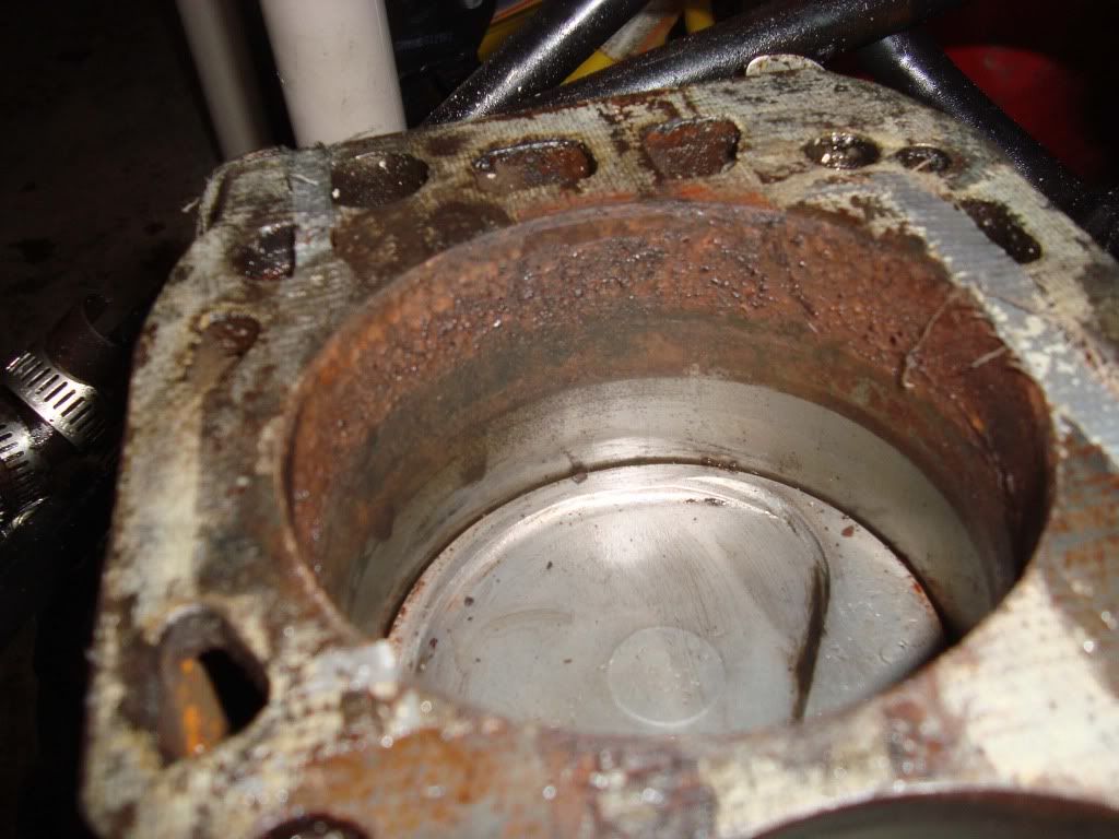

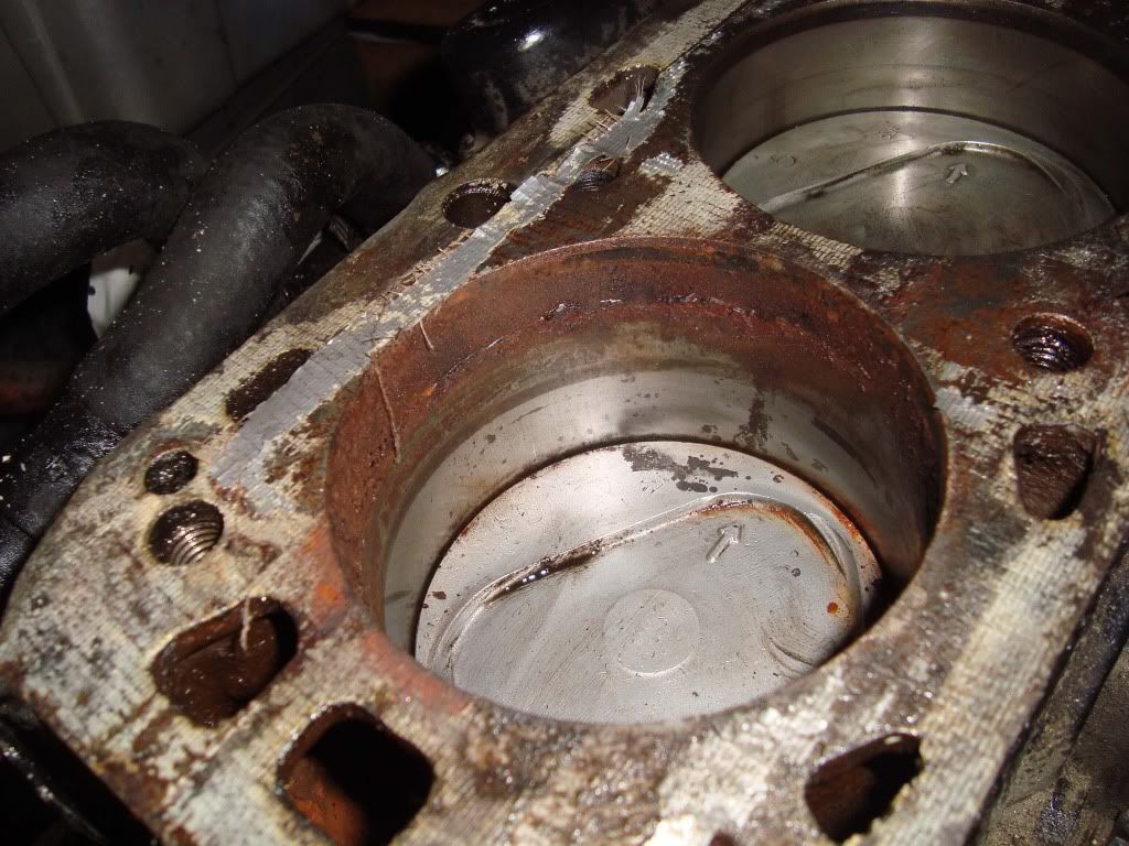

Well I pulled my rebuilt block out of my shed to rebuild my motor on my latest $100 Tbird purchase. Well I'm prepping the block by moving all the needed parts form the one block to the other, so That I can have it installed and running by tomorrow. I'm instaling the clutch and as Im turning the crank the put in the bolts, the crank locks after 3/4 turn. Well I taped off the top of the block with duct tape and when I pulled it back I was in F'ing shock!! The #1 and #4 piston had rust at about 1/4 of the top of cylinder wall!!
Is there a possible fast fix or do I have to rebuild this mofookie!!!

http://i158.photobucket.com/albums/t97/biggrgivens/piston1otherside.jpg
http://i158.photobucket.com/albums/t97/biggrgivens/piston1.jpg
http://i158.photobucket.com/albums/t97/biggrgivens/piston4.jpg
http://i158.photobucket.com/albums/t97/biggrgivens/piston4otherside.jpg
Is there something I can put in the cylinder to remove the rust? Can I just hone the top a little? Is there an abrasive pad/chenical that can fix this mess?:mad::mad:

You can try starting with a Scotch Brite pad and some Marvel Mystery oil, but I'll be honest #1 don't look too awful bad but #4 looks scary
Good luck
Need a fast fix to get this Bird up and running
Try some emery cloth maybe.
cylinder hone.
You can try what ever you want but that much rust will pit the cylinders.
Sorry see that happen to you.
Been there done that b4 too
pull the pistons and hone it, then check clearance between the cylinder and piston, no magical fix to do it the right way.
John
Quote from: hcor;350601
x2
X3...only one way to do it right, but about 375 ways to cause you to have a bad engine very shortly. Sucks, but somehow partially disassembled engines draw moisture like nothin' else..
Bummer. Looks too bad to go with from the pics.
