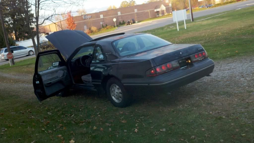

I have a rust hole at the peak of my wheel arch. Does anyone have some of a fender laying around?

most current pic of the car, damage above rear tire
(can you guys see why I want to get the body fixed and painted?! lol
Poor boy turned pink and is now rusting...

Honestly that would be easy enought to make out of some flat sheetmetal rather than cutting up a fender or quarter panel. I assume you are going to weld it in?

...and the underside lip of a fender is diff from the quarter panel lip. if it's rusting, then the entire inner/ outer panel needs to be separated and treated, otherwise any repair on that will rust again, and just come back bigger then it is now.
It can just be repaired pretty easily though.

What are you talking about? bondo and fiberglass!
kidding, I plan on welding it in, I was gonna practice on a new panel on my old chevy van first though... see how it goes.
how hard is it to separate to get to the inner fender?

You would have to drill out the welds along the wheelwell, pry apart to expose, and treat any rust between the 2 panels

paint flaking off isn't really a concern, it has to be stripped of all paint anyway or it'll burn off when he welds it in lol

I dont mind flaking paint, just flaky rusty metal :P
