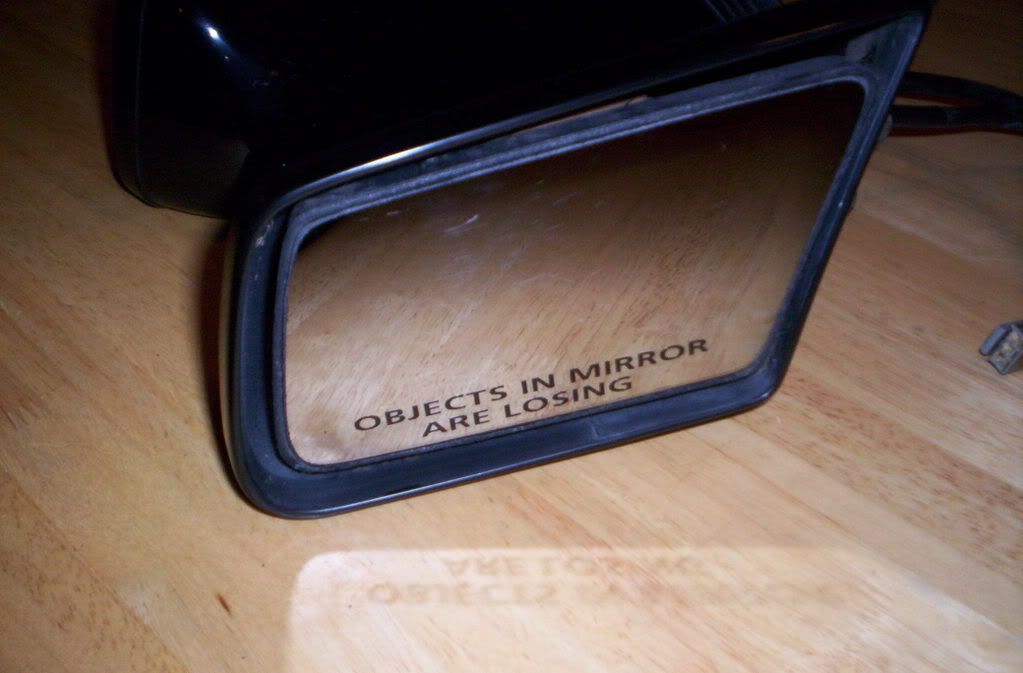

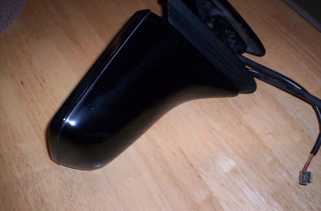

I took the py 20 year old mirrors off of the Sport and decided to clean them up.I wet sanded them with 800,1000,and 2000 grit,then polished them with Mother's Billet Polish.They turned out great.No paint to chip,just shiny plastic (they are shinier than the pics show,I can see myself in them).The whole process from start to finish took about an hour..
Here's a "before" shot.....
Here's an "after" shot.....
Another one.....
The last one (I like it).....
