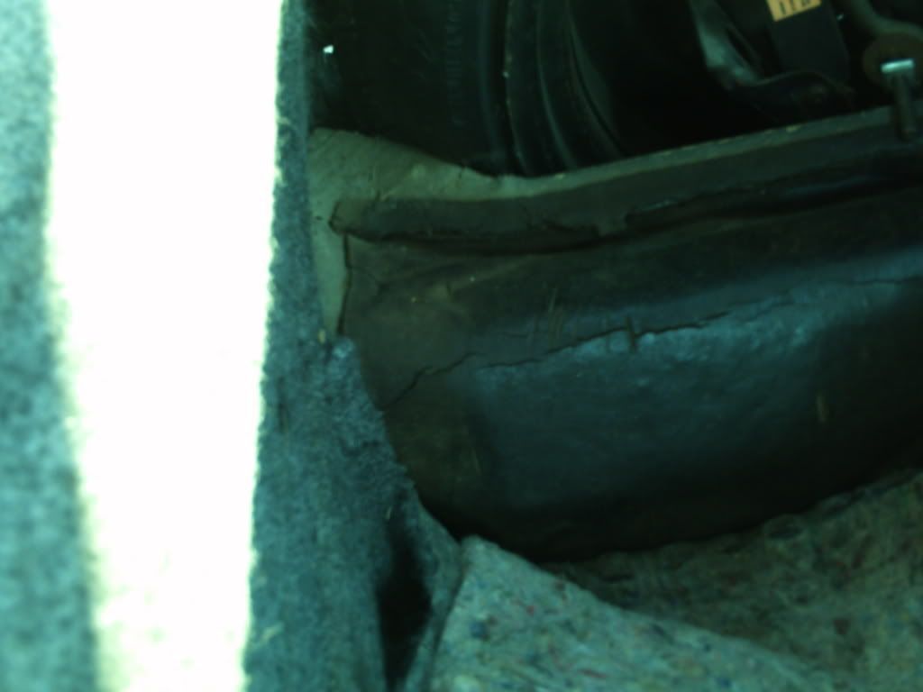

under it. it just pushed in to the exhaust and in the the tank just a bit.
i got pics of the trunk and puting them on next post

Sorry man but that frame is bent bad.
Look at the rear cross brace in your picture.
That brace is for structural support and it's bent pretty good.
Also your trunk shifted because the framework that holds the supports is bent to hell.
The creasing on the pass 1/4 also confirms that the whole rear end of the car is shifted over a few inches.
Like said a few previous posts ago(anything is fixable depending on how deep your pockets are)but you can pick up another car in nice shape with low miles for what it would cost to fix that.

that whole axle has to be shifted over to the pass side some.  and you know whats attached to the axle.
theres just so much darn interior bends to be taken care of first before you could even start to place donor exterior skin on. man thats a hard one but its your choice.
I vote common sense and carry a ton of her parts over to another car, perhaps even the motor.
If you carry over a ton of parts including the tranny and motor, then she never died, just got a nice make over.  The heartbeat of your car is the pieces parts inside and and under the hood.  Give her a face lift on another car with a blown motor / tranny.
