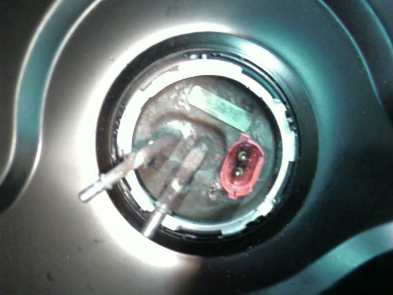

o pick me i can help. i had all kinda pics when my new tank was in my shed. its not rusty and its a new ring and tank so you can see what it looks like,and lol, i installed my ring with a garden hand held hoe to smack the tabs lol
BOOM
sorry for shiznitty cell phone pic but it was late at night

but yeah that ring that got really brightened by the flash is rusty as is everything in that area, and it seems to be all frozen together. guess ill have to just find a new tank. the car runs good and i get no bogging or hesitation but after that thread about the H.O. pumps, man, i wanna try it and see if she gets any faster! lol. you never know!!!

the tank came with the car. id say let some pb sit on there, and start working it out, you can get new rings, matter of fact i think i got the original one around in the shed, ill give you it if you want
