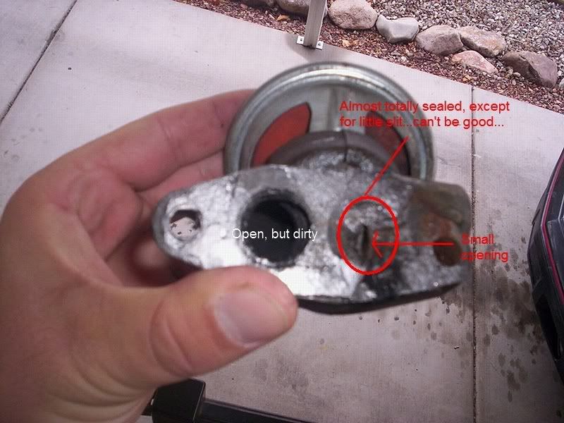

Ok guys, I took the EGR valve off this morning, and to my shock and amazement, I saw the following:
The EGR appears cracked, so it's going to have to be replaced. I might not seem like I know all the much about cars at times, but I'm pretty sure that hole in the EGR is supposed to be open and not sealed.

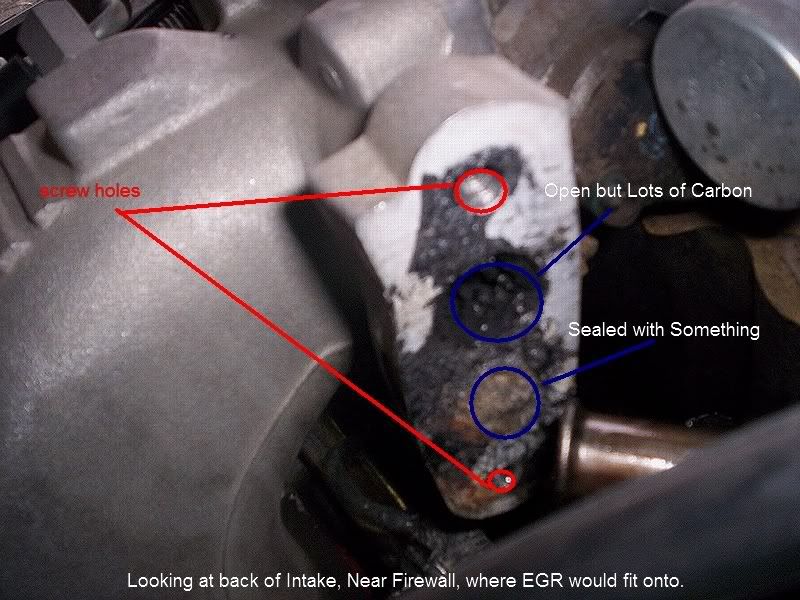

The previous owner appears to have used JB weld to seal the crack in the EGR. I'm praying that's not what's clogged that Hole in the Upper Intake...if that's the case...I'm SOL.
Someone please tell me that by making this horrifying discovery, I may have solved my strange engine running woes. I mean, surely having those two holes plugged can't be right!?

There's supposed to only be one open hole on the EGR valve and on the intake. The gasket has two holes in it but I dunno why, I assume for other vehicles. Nothing's wrong as far as that goes.

No...There is only one EGR hole in the intake.
You will have to replace that EGR valve though.

Well that's a relief. But , I figured this was going to be the reason for my Weird Idling problem. Surely having a cracked up EGR can't be good for the engine though.

Well your picture sucks, so it's hard to tell where it is cracked.  If it is cracked and allowing extra air into the engine at idle, it will idle high.

u can see where its cracked almost half of it is gone

Well, I went the junk yard and found a good EGR and put it on The Turbo. The idle seems better and much lower. It hasn't spiked to 2k while in park. I also didn't have that "lurching forward" feeling while sitting at a light holding the brake down.

oh and just FYI that hole that was "clear but dirty" thats FINE. thats called carbon dust deposit. its probably 1/32nd inch or less thick. like the inside of your tailpipe. theres exhaust flowing through it, so the tiny carbon particles WILL stick to the walls ALWAYS. no way around that. but nobodys lookin at that so its no hit to the looks of your car, lol
