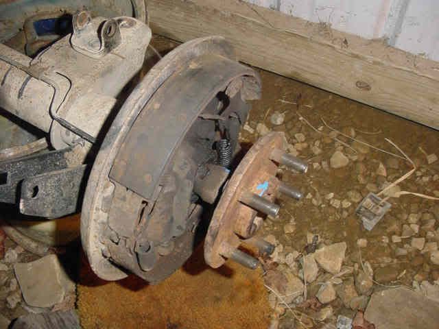

Sn95 Axle in 86 to 88 cat/bird axle housing.

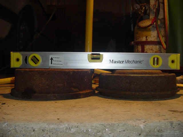

Rangers use wider shoes than fox's.  but as you can see the drums are the same height to the wheel .  So yes to this point they will work.

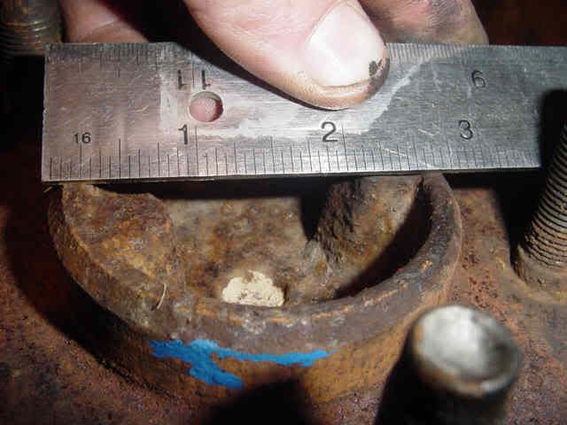

Now we see the real issues.  This is a fox axle.  2 1/2" wide here.

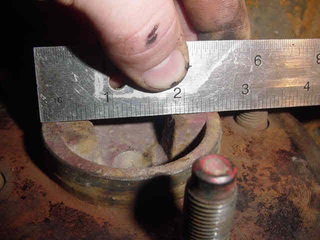

Sn95 axle in this picture.  Same measurement is 2 13/16"

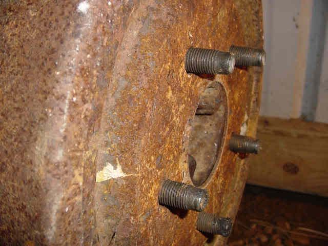

Now here is a picture of a drum ment to fit a 7.5" ranger axle.  Notice how it will not slide over the center.
