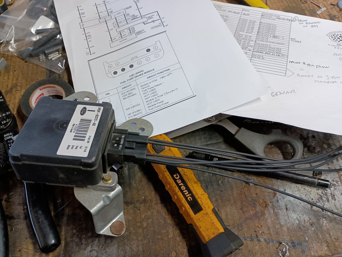

OK, finally got the parts I was waiting on.
That's a FPDM (Fuel Pump Driver Module) from an '02 Mustang, but pretty standard for many of the '99-04 Fords with the returnless fuel systems.
Originally, I was going to try and use the '11 FPCM (Fuel Pump Control Module), but was going to have to find a way to spoof the signal from the RCM (Restraints Control Module). After '05, the cars did away with the inertia switch and used impact sensors over CANBUS to feed the RCM and that would be used to shut down the fuel system in case of an issue. I was going to feed a 10Hz square wave signal to the FPCM, which is supposed to be the "all clear" to allow pump function. That still may work, but I figured there had to be a way to do things without that.
Not having spent much, if any time with Mustangs past '00-'01, I never even knew about all of this.
Anyway, the car with the FPDM also used an inertia switch, to interrupt power to the fuel system in case of an crash, and still modulated the fuel pressure based on the need.
I'm replacing the earlier "white button" inertia switch with the later "red button" one, which is rated to carry the full current load for the fuel system, instead of just a control voltage for the the old FP relay.
This was the last of the stuff I needed to get my fuel system stuff wired up and be able to start doing power-up and systems checks.
I still have a good day of getting things wired up to the bulkhead connector to do these tests, but I finally have pieces in hand to hopefully make that work.
