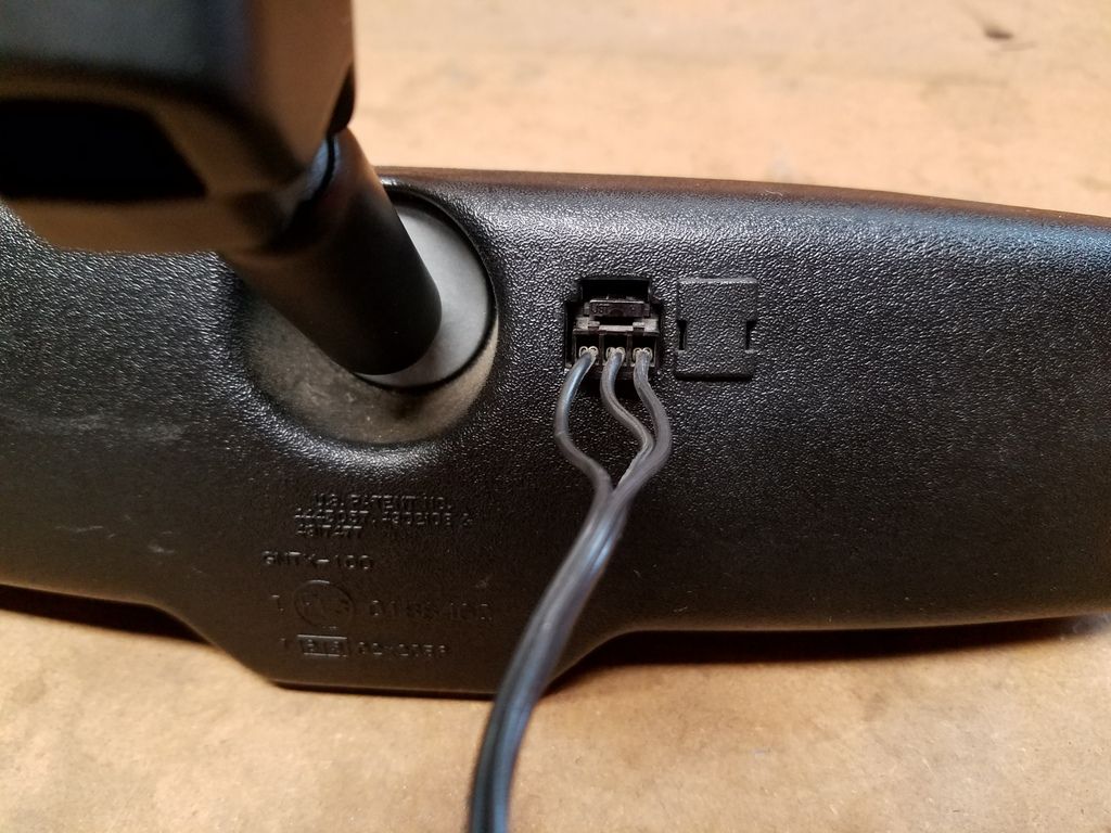

I was able to procure the auto dim rear view mirror from a 1990 Mark VII and install it in my Thunderbird. It was a pretty easy exercise. Make sure you get the mirror connector plug otherwise you're SOL on connecting the mirror. Looking at the back of the mirror the connector has three wires.
Left to right the wires are: power, ground, and reverse off. Obviously the power wire is connected to a 12V switched ignition source and the ground is, well, connected to a ground. Those are the only required connections for the mirror to function. The third wire, reverse off, turns the mirror off when the car is placed into reverse. This wire is optional as the mirror will function without it connected. To have this function work you have to connect this wire to the backup lamp power wire.

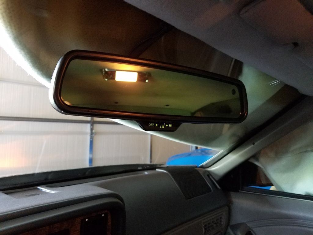

So once you make a couple connections you can have a modern electro-chromatic auto dim rear view mirror that works with the auto headlamp dimmer sensor. It looks factory as well because it was factory fitted to Lincoln Mark VIIs. I really like this simple modification.

Very cool idea!  Im wondering how these work if the back glass is tinted? Im planning to 50% tint the 3 sides of my car so that would cut down the intruding light behind me a little.

Turn the adjustment from low to high. That should compensate for the tint.
