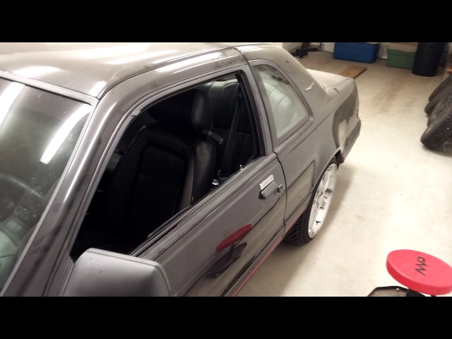

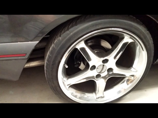

November update video: I had torn apart my cluster and dash to fix and replace burnt out bulbs, repair the flexible circuit board, clean all my gauges and plastics, and I did the tach resistor conversion to make my factory tach V8 worthy! Also discovered the reason I had some up-down play in my steering column, there were 2 large bolts loose tucked between the turn signal indicators. Tightened those up, and also pulled the steering wheel off and decided to go aftermarket with a Grant 415 Challenger. I also bought stainless steel hex bolts for the face of it. And yes I hooked up the hub properly so the horn works! I want to replace my y horns with something a little more manly. I like the one in my Jeep Liberty, I might look at doing that in the future. I also rid of the 1" spacers on the rears.

December Progress: Rear brake work and spacers done
https://www.youtube.com/watch?v=vM-9l6oRd8A
Window that fell off track fixed! Also re-finished my door lock/unlock pieces.
https://www.youtube.com/watch?v=NRqd_gcc_7M
