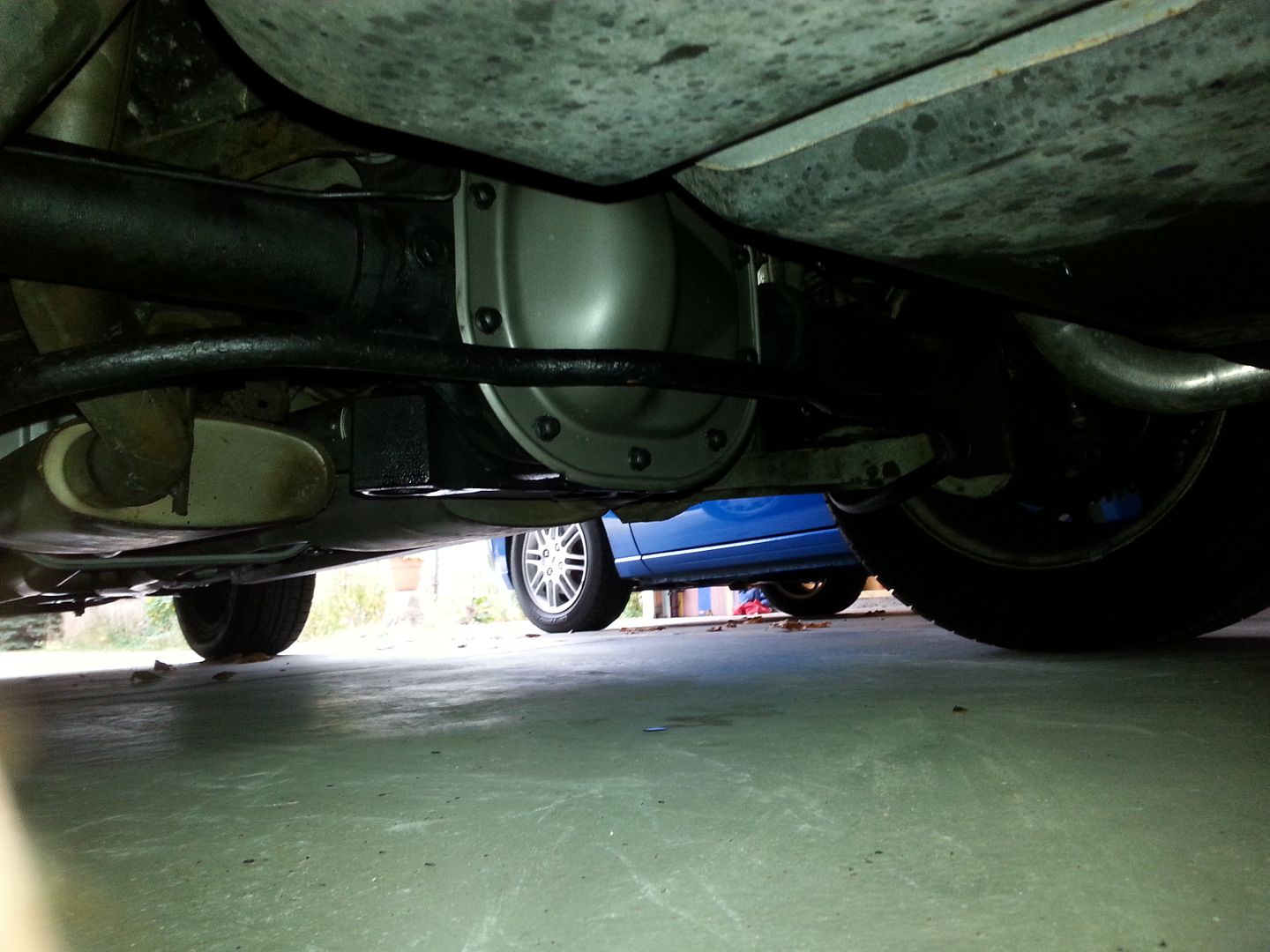

So here's a picture of the rear in the car.
I discovered a little issue after installing the rear. I reused the stock springs but took out the original stock spring isolators and replaced them with new poly isolators. Now the rear of the car sits about 1/2" higher and about the same amount higher than the front.
I was planning on replacing the rear control arms next year so I should be able to fix the problem at that point. I'm going to go with some Maximum Motorsports adjustable lower rear arms: http://www.maximummotorsports.com/Extreme-Duty-Adjustable-Rear-lower-Control-Arms-1983-1989-Thunderbird-P1444.aspx and some Mach 1 or Bullet springs. That way I can get the rear ride height correct.
