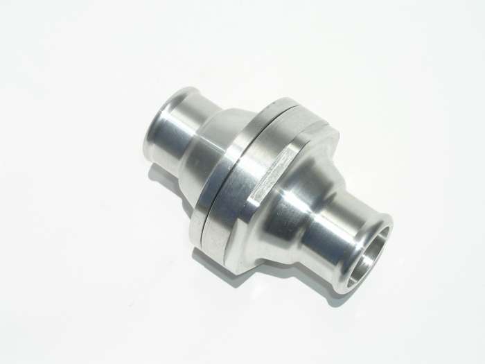

Why not just use a t-stat in a hose if it bugs ya that much?
improved tsat location CHUCK W?
toms comments on studs make sense to a degree yet now you add a nut to the bottom connection.  the water pump housing is too much in the way of the work area.
but a tstat in the hose? interesting..........?

Lots of small dohc i-4's have a small plastic housing that splices into a radiator hose.
then you could just make a 90° adaptar for your intake and put.the t-stat somewhere inline.
ill bet an old thermostat housing and some pipe fittings, or a trip to the junkyard and you will find something cheap that would do the trick.
it couldn't be all that hard to find a threaded water pipe you could fit a stock thermostat in and then just stick an o-ring on the side you want sealed.

Jay changing that stat is a simple thing that i personally do not give it a second thought. High tac to hold the stat in the manifold 2 studs and a sleeve and it is simple as pie. Now if you want to change a difficult stat change one on a V6 Chrysler 3 hours or how about a VW GTI. The ford stat is a bit difficult but not that bad. use the studs and the High Tac or super weather strip adhesive that will prevent the stat from moving prior to installing the housing.  Or use an inline stat which is another option i guess. Have a good weekend guys.
If you are having trouble catching the nut if you stud the lower bolt hole use one of these nuts or a TAP bolt adjusted to length with 2 nuts. Either method works easily and brings out the tightening point past the place where it will be easily tightened. There you go JAY!!
