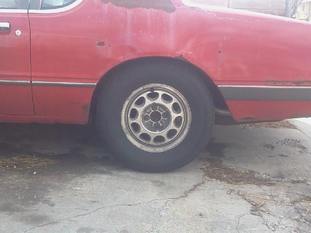

15x4 Fronts 205/60R15 and 15x8 4.5" back spacing 275/50R15 Drag Radials? What wheels and back spacing and tire size is everybody running?

Stock 10 holes I have 275/60's. they rub if I go over a curb at an angle too fast, but not otherwise.id go a hair smaller next time. I'm digging the 255/60 on v8deamons cat.
