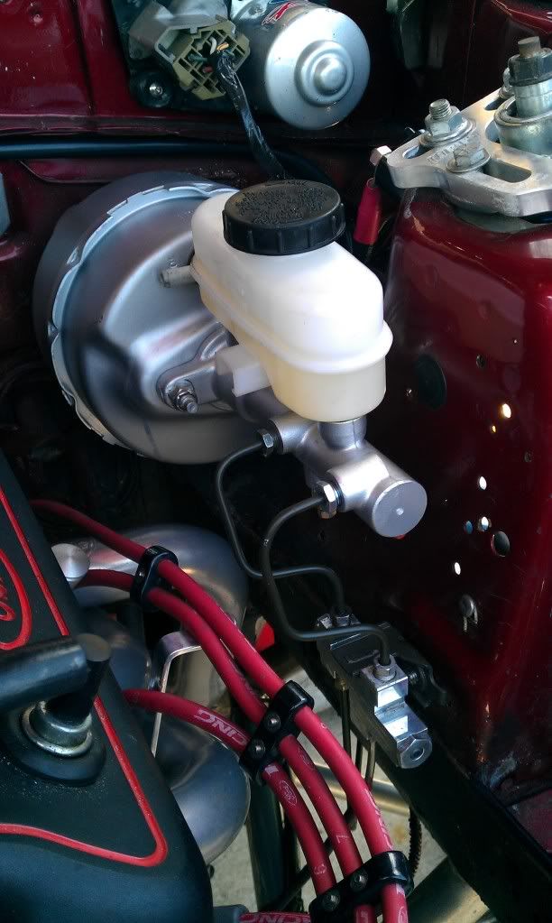

got a 1990 mustang booster, came out great
